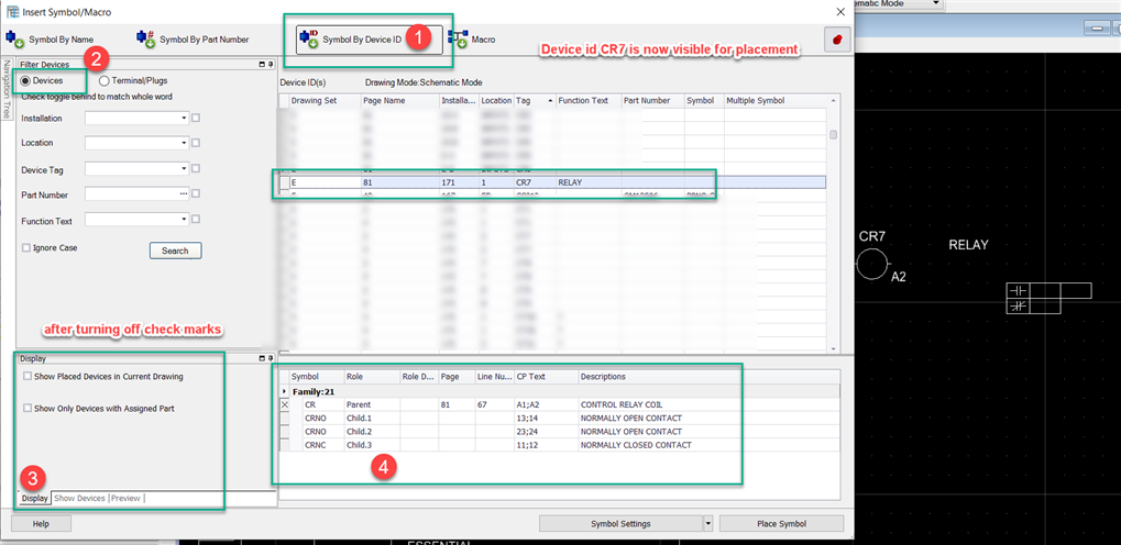

Symbol by Device Id is used to place the symbols in the schematic mode which are associated with the same family. Or current mode symbol in Current mode which are associated with Part Number.
After placing symbols or devices in SLD, Schematic, Panel layout pages, when the user further wants to place the same or related family members by using “insert by device id” command, device id won’t appear in insert by device id window.
Steps to Resolve: -
Note: Sometimes software sets default settings to tool setting window of “Insert by device-id”
Before turning off check marks (as shown in below image)
1. For Example, Place symbol named “CR” in schematic mode, assign family as “21” (2NO,1NC), and device id as “CR7”.
2. In the same page or in other page modes, click on “insert symbol by device id” command for further placement of child symbols.
3. The device id “CR7” won’t be available or visible in the list. as shown below.
After turning off check marks (as shown in below image)
4. After opening the “insert by device id” window, the user can turn off the checkmarks and can check whether the device id is now available or visible for placement. As shown in the below image.
Based on the user requirements, the user can control the display of placed devices in the above (marked 3)window.
