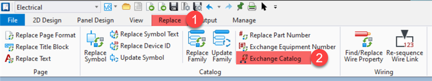

Exchange Catalog can be used by users to replace all symbols in Schematic Mode or the entire Project, with symbols of the same names found in the Catalog Paths of a specified setup configuration. Symbols without a definition found in the catalogs are not replaced.
Uses for the Exchange Catalog tool include:
1. Select Replace >> Exchange
2. Select the Catalog, specify the Project or Schematic. And select the settings as per requirement.
