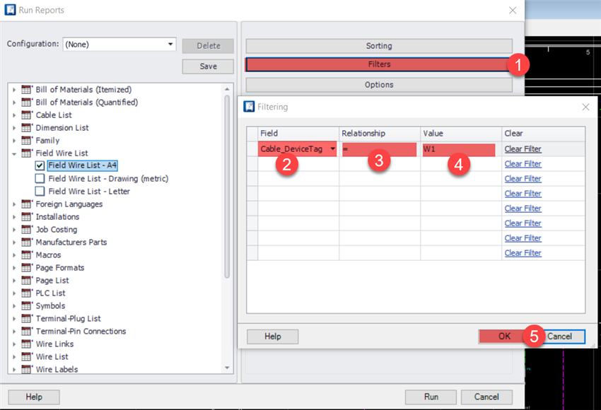

Example 1 - Filtering Field Wire List for all connections to particular cable for example a Cable with Device Tag "CAB1"

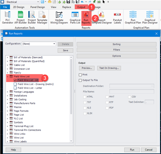

  1. Select Output >> Run Reports >> Field Wire List and select any Report Template.
  2. Select the Filters button and then from the Field drop-down list select "Cable_Device Tag" select the Relationship to "=" and specify the Cable Device Tag as Value for example "W1" as seen in below image and select OK.

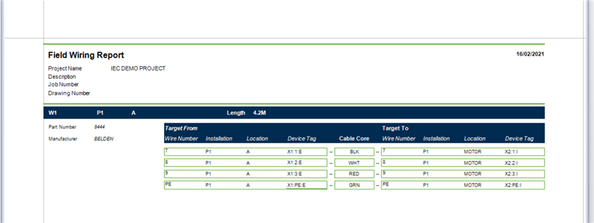

  3. Now Run the Report to file or select to Preview the results.

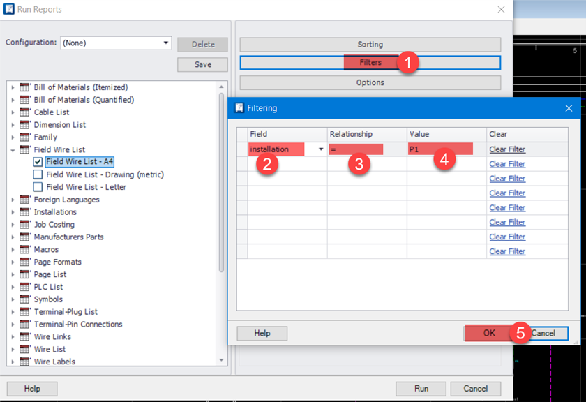

Example 2 - Filtering for all cables connected to devices in Installation "A"
  2. Select the Filters button and then from the Field drop-down list select "Installation" select the Relationship to "=" and specify the Cable Device Tag as Value for example "P1" as seen in the below image and select OK.

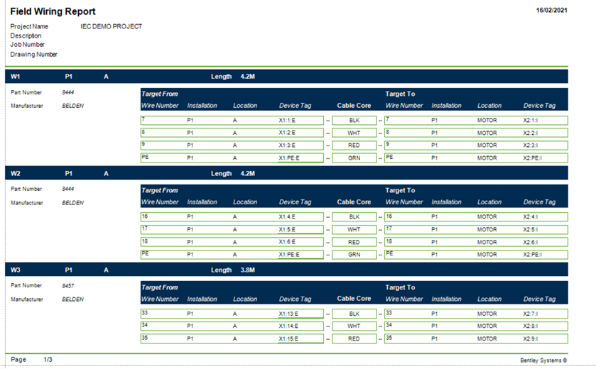

The resulting report should provide a list of all information for the conductors whose Target 1 or Target 2 device Installation name is "A". Conductors whose Target 1 and Target 2 device Installation names do not match this filter will not be listed. Therefore unused conductors will also be excluded from the report.
