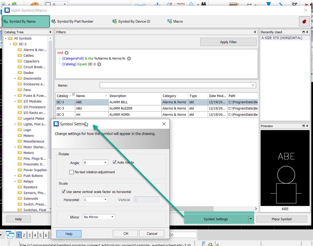

When symbol insertion is affected
  1. Select Insert Symbol By Name.
  2. Click the Symbol Settings link or button.
  3. On the resulting Symbol Settings dialog, change the value of Rotate Angle to "0",  change Mirror to "No Mirror", and set the Scale value to "1".
Subsequently inserted symbols will then appear as created.  To "fix" symbols already inserted, right-click the symbol graphics and select Symbol Settings, then perform step 3 of the above procedure.  Or delete and re-insert them after performing the above procedure.
Another cause could be that the symbols are auto-rotating based on the orientation of the wire on which they are being placed. To disable this behavior, clear the Auto Rotate check box on the aforementioned Symbol Settings dialog.
Yet another cause could be that the symbols are being inserted from an inappropriate catalog, often JIC-3/ANSI-IEEE vs. IEC.

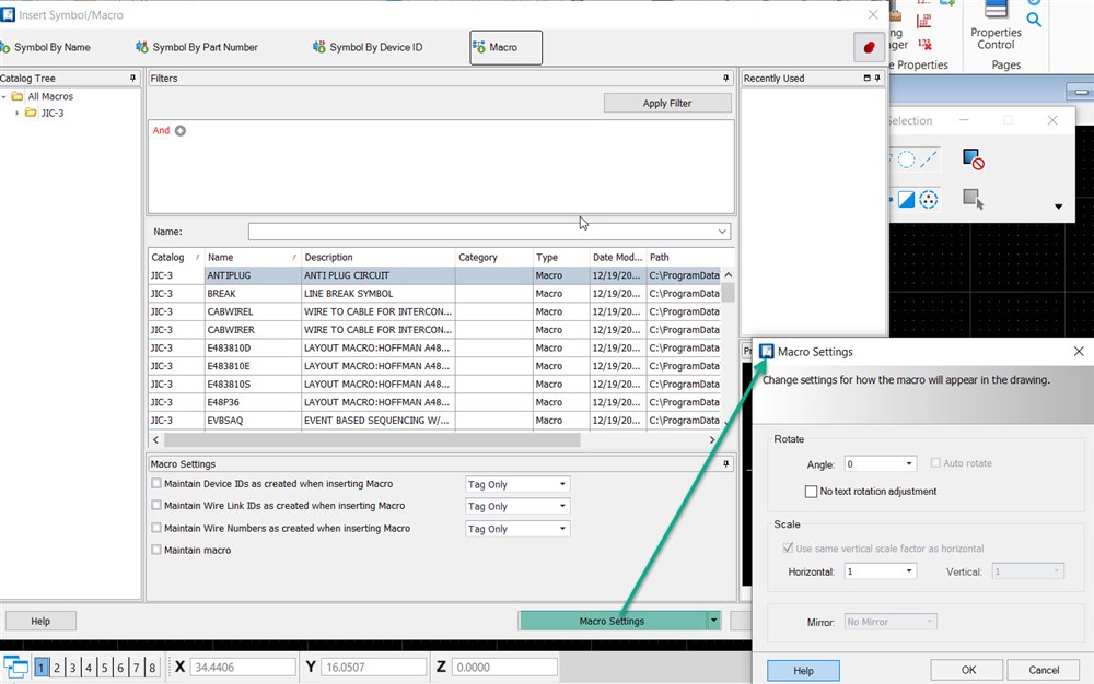

When macro insertion is affected
  1. Select Insert Macro.
  2. Click the Macro Settings link or button.
  3. On the resulting Macro Settings dialog, change the value of Rotate Angle to "0", and set the Horizontal Scale value to "1".
Subsequently inserted macros will then appear as created. To "fix" a macro already inserted, it might be easiest to delete and re-insert the macro. Another cause could be that the macros are being inserted from an inappropriate catalog, often JIC-3/ANSI-IEEE vs. IEC.
