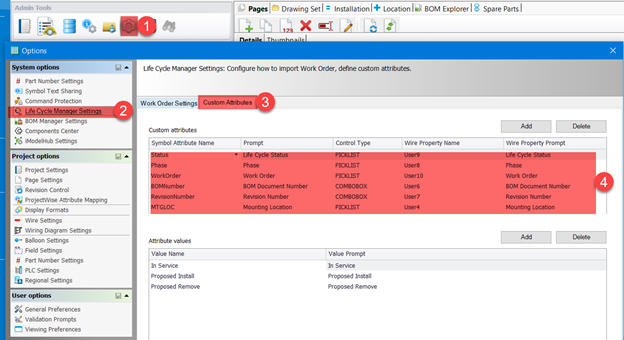

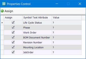

The user can use the Life Cycle Management (LCM) function in Substation which is used for assigning different Custom Attributes Values to a Substation Equipment. These attributes can be controlled and defined from the Life Cycle Management option under the Systems Options which will control the attributes in the Properties Control Dialog.
In some cases, the user might want to use Custom Attributes instead of the default Attributes in the Life Cycle Management settings. Further in this article, we are going to see how to do the same by using the example of the Work Order attribute. This needs to be done by following below steps

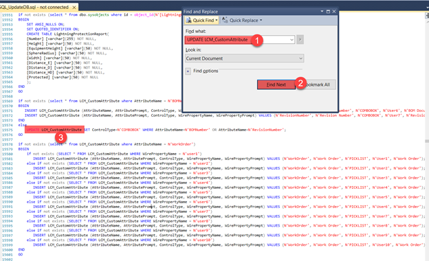

3. After the script has been updated with details, use Find and Replace (Ctrl + F) and search for “UPDATE LCM_CustomAttribute”

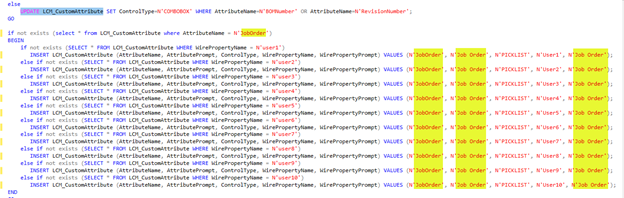

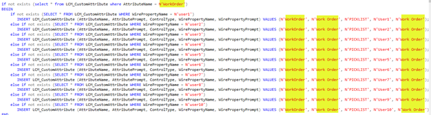

4. Now few lines below the searched line replace all the “WorkOrder” attribute with the required custom attribute name or according to the details followed while creating custom attribute at the beginning of this document. In the below images you will find highlighted text details for Custom Attributes that need to be updated. Also, another screenshot with the updated details is also provided.
After changes for Custom Attribute in place of WorkOrder

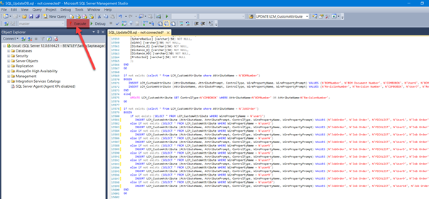

5. After making all the above changes select Execute to run the script to update the database.
6. Now after the script has been executed successfully Launch the Substation and check the Life Cycle Management Attribute & Property Control if the details for Custom Attribute has been updated have been updated.

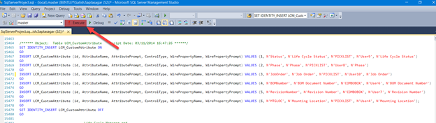

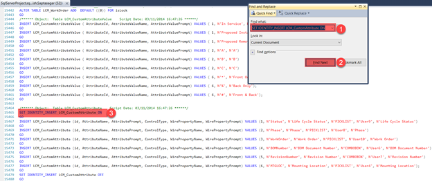

1. Browse to the location “C:\Program Files\Bentley\OpenUtilities Substation CONNECT Edition\Substation\Electrical\SqlScripts” on the machine where OpenUtilities Substation is installed and open the file “SqlServerProject.sql” into SQL Management Studio. If the script is being executed from the Server machine then the files need to be copied to the server machine if the OpenUtilities Substation is not installed.
2. Follow the below Wiki links details for updating the details of the Project Database that needs to be created by following the Create the Database Method 2: Executing a Script.
communities.bentley.com/.../creating-and-updating-the-project-database---substation-ce
3. After the script has been updated with details, Find and Replace (Ctrl + F) and search for “SET IDENTITY_INSERT LCM_CustomAttribute ON”.

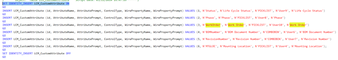

4. Now for the insert statements below the search line replace the “WorkOrder” attribute with the required custom attribute name or according to the details followed while creating custom attribute at the beginning of this document. In the below images you will find highlighted text details for Custom Attributes that need to be updated. Also, another screenshot with the updated details is also provided.
5. After making all the above changes select Execute to run Script to update the database.
