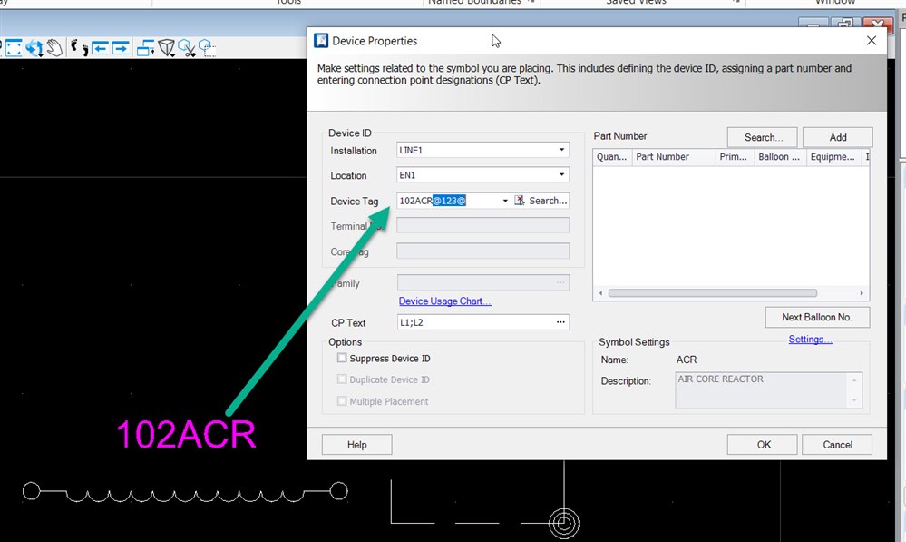

Users might need to use hidden text attribute you can use @ example_text @( ie. attribute in-between Device ID).
1. Open Device Properties dialog box and in Device tag ie. deviceID@ text @.
