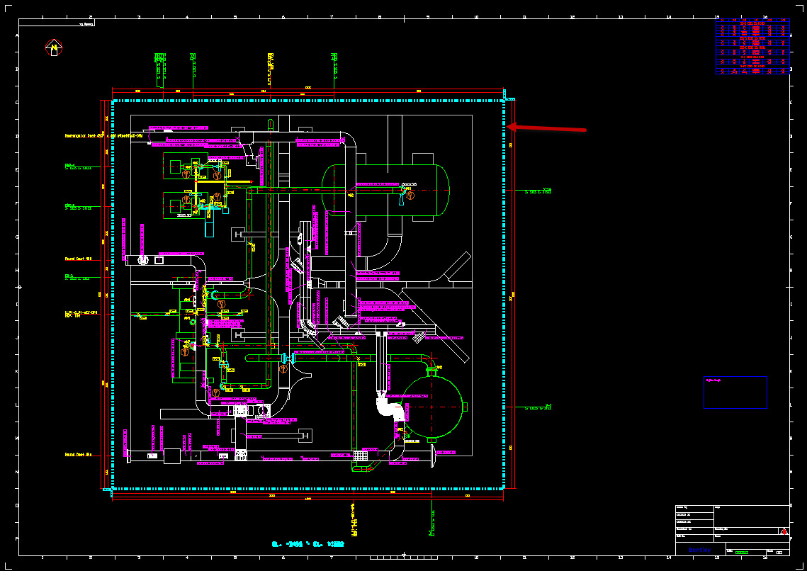

By default, frame of the output drawing is Cyan color as shown below.
If user wishes to change the color of the frame, steps given below will help in achieving this.

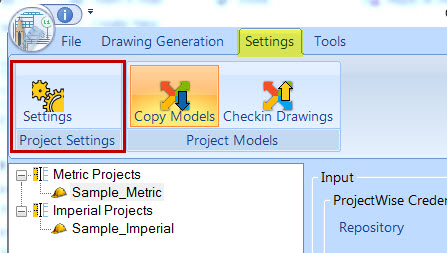

  1. Open settings from the Settings tab for the project you are working on.

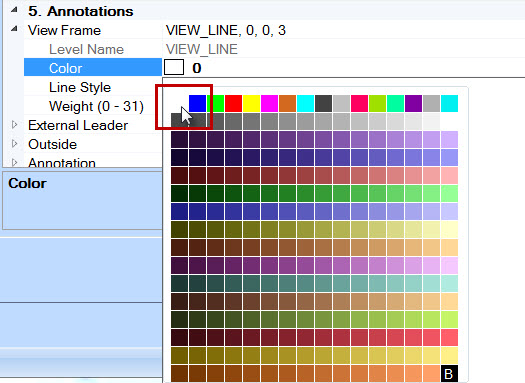

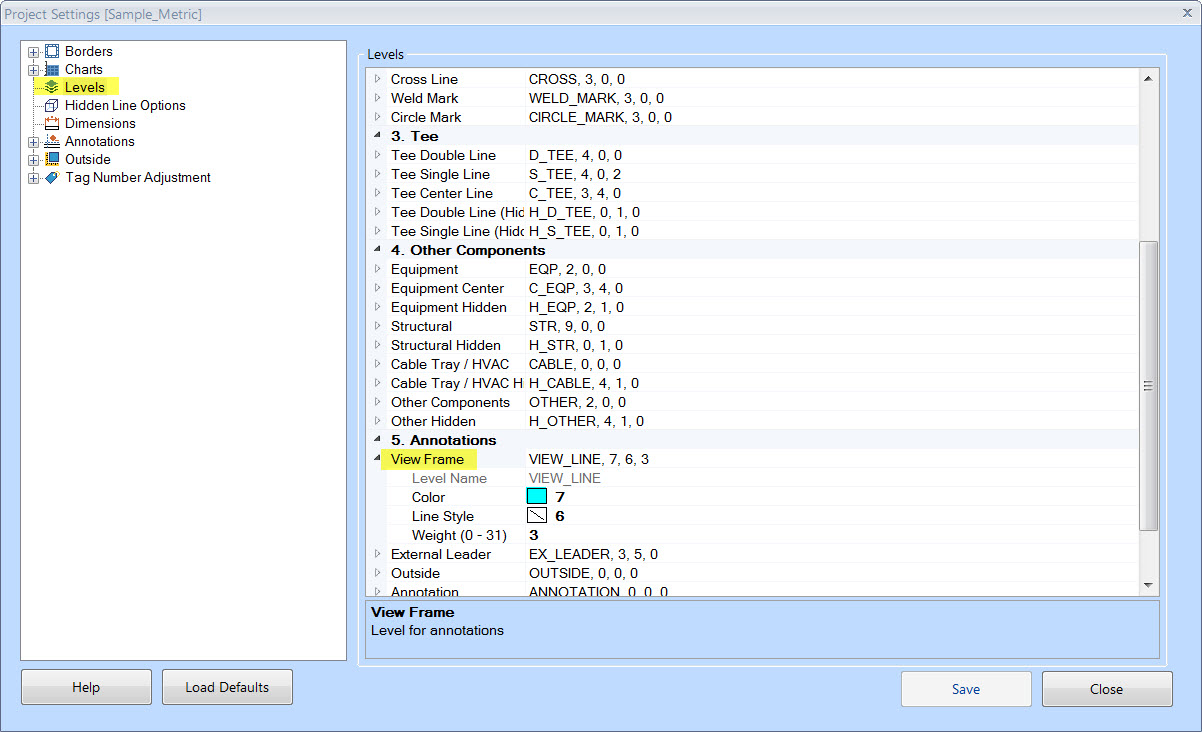

  2. In Project Settings dialog, select Levels and go to View Frame setting under 'Annotation' category in right pane.

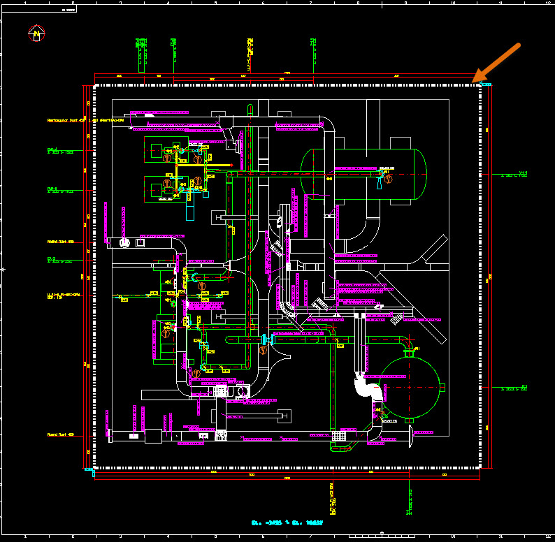

  3. Let's change the color from Cyan to White.
    In the similar fashion, Weight & Line Style can be changed.

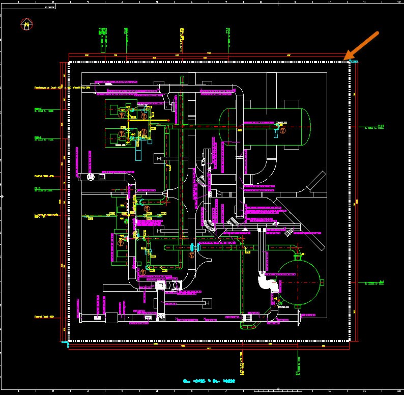

  4. Save the changes and generate the drawing again to verify the result.
