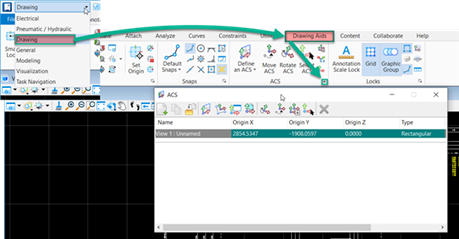

  1. Select Drawing Ribbon mode ->Drawing Aids ->Manage ACS.
  2.   ACS dialog box opens.

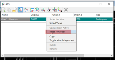

  3. Right-click on the View, in the screenshot the view is “View 1: Unnamed”
  4. Click on Reset To Global.

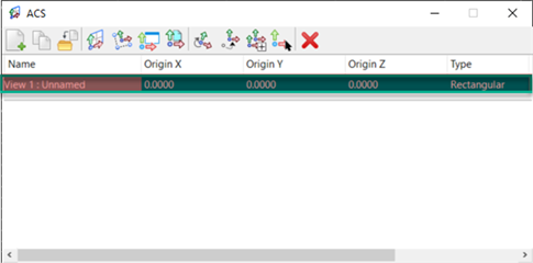

  5. You can see the ACS got reset to 0,0,0.
