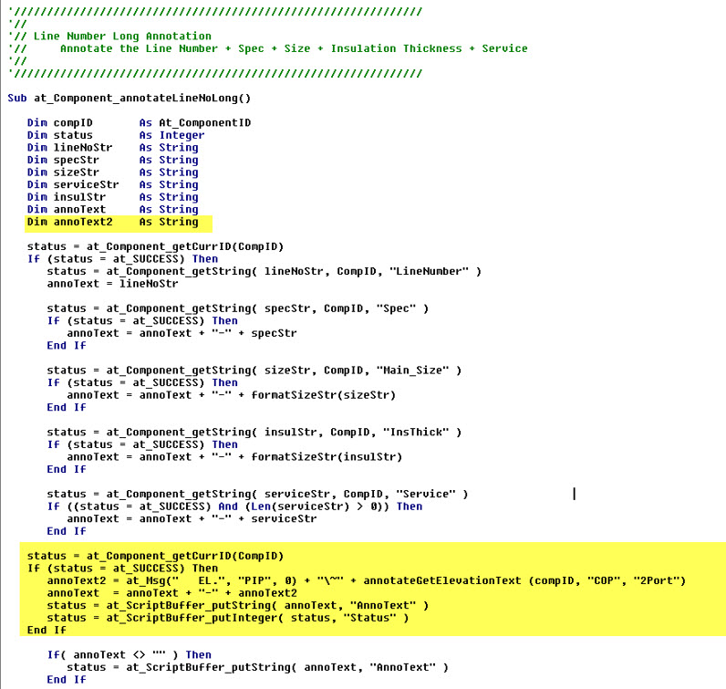

Some user may have project requirement to show pipe line long annotation with center line elevation. Need to edit ‘annotate.ebs’ file as per below mention steps:
  1. Go to following path.
    C:\Program Files (x86)\Bentley\Plant V8i\Modules\Base\piping\Util
  2. Take back up of original ‘annotate.Ebs’ file.
  3. Open ‘annotate. Ebs’ file in script editor.
  4. Add following entries.
    status = at_Component_getCurrID(CompID)
    If (status = at_SUCCESS) Then
    annoText2 = at_Msg("   EL.", "PIP", 0) + "\~" + annotateGetElevationText (compID, "COP", "2Port")
    annoText  = annoText + "-" + annoText2
    status = at_ScriptBuffer_putString( annoText, "AnnoText" )
    status = at_ScriptBuffer_putInteger( status, "Status" )
    End If
    Refer below screen shot:
  5. Save annotate.ebs file.

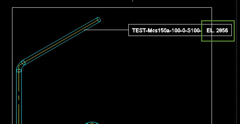

  6. Open AutoPLANT. place Long annotation
