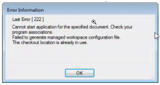

Error Message: Last Error 222 when opening a Project Page located in ProjectWise with Promis.e CONNE
 Product(s):Promis.e CONNECT Edition
 Version(s): 10.00.XX.XX to 10.11.XX.XX
 Environment: NA
 Area: ProjectWise Integration
 Subarea:
Background:
The user gets the error message Last Error [222] as in below screen shot when opening a Project Page located in ProjectWise using Promis.e CONNECT.
Steps to Resolve
The to resolve the issue user must have Read, Write, File Read, File Write permission for Project Page. Hence the ProjectWise Administrator needs to assign these permissions to the user for the project pages.
