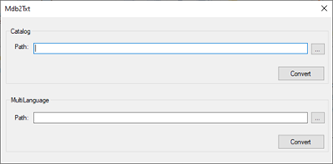

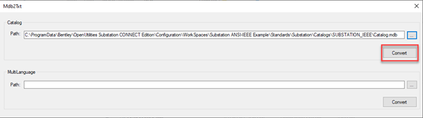

3. Open MDB to TXT conversion tool. Locate Mdb2Txt.exe in folder "C:\Program Files\Bentley\OpenUtilities Substation CONNECT Edition\Substation\Assemblies"
For OpenUtilities Substation 2023 or higher use below path
"C:\Program Files\Bentley\OpenUtilities Substation 2023\Substation\Assemblies"
4.
Select desired Catalog.mdb file using browse button.
5.
Click Convert. Then Click OK.

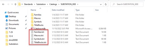

6. Verify conversion. Open Catalog folder using Windows explorer. Verify that the following txt files exist.
7.
Repeat Steps 4 through 6 for each Catalog within your configuration.

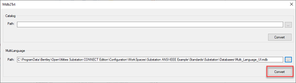

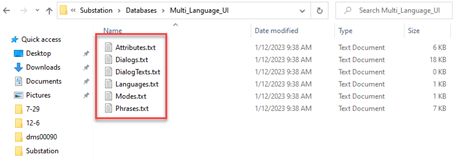

8. Select desired Multi_Language_UI.mdb file using browse button.
9. Click Convert. Then Click OK.

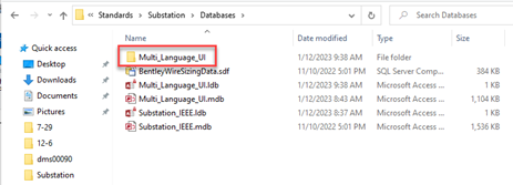

10.
Verify conversion. Open Databases folder using Windows explorer. Verify creation of new folder and txt files.
New Folder
New Folder Contents

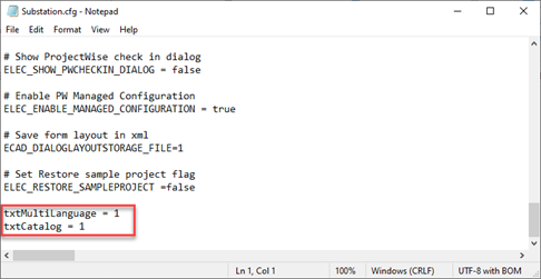

11. Add configuration variables to one of the three *.cfg files mentioned in beginning of this document.
Note: This step is not necessary if you are using OpenUtilities Substation 2023 or higher.
Use below Text to Copy into *.CFG file
txtMultiLanguage = 1
txtCatalog = 1
Example edit made to Substation.cfg file.

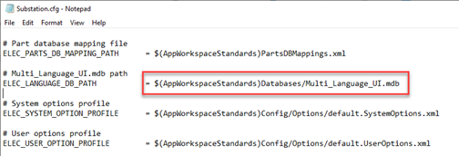

12. Change ELEC_LANGUAGE_DB_PATH variable value. This variable resides in Substation.cfg.
Set this variable's value equal to the folder path of your Mutli_Language folder.
Copy below text to Substation.cfg file to replace with existing cfg as highlighted in the below reference images.
ELEC_LANGUAGE_DB_PATH           = $(AppWorkspaceStandards)Databases/Multi_Language_UI/
