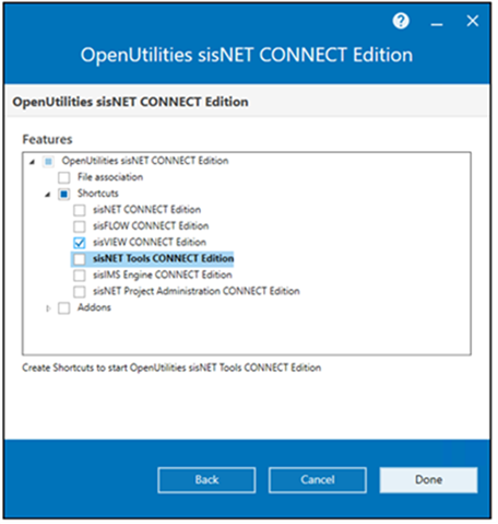

    You can avoid DGN files being associated with sisNET, during the installation of sisVIEW and sisFLOW. If you do that, the DGN file will not be opened with sisVIEW or sisFLOW when double-clicking, neither will it pull a sisNET license unless a user explicitly opens a DGN file with sisNET. To configure this, keep the” File association” checkbox empty. See the screenshot below from a sisVIEW installation:

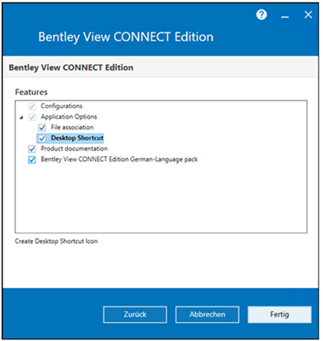

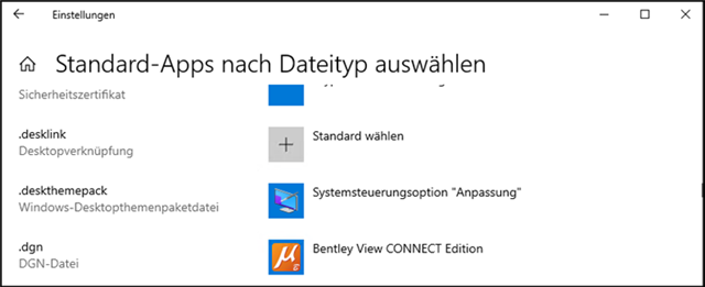

    In addition, you can associate DGN files with Bentley View, the free of charge Bentley tool for viewing DGN and DWG files. See the screenshots below:
