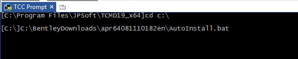

In many instances Network Administrators have to roll-out a "silent" or scripted installation of the Plant applications. In this example we will describe the supported procedure for this requirement.
Note: If ProjectWise is required for Plant applications it must be installed and properly working before this silent roll-out.
Note: These script instructions are for clean installations only. If previous versions of these applications are on the workstation the script will not run.

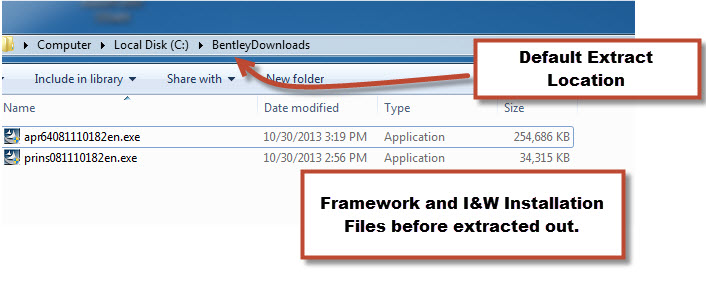

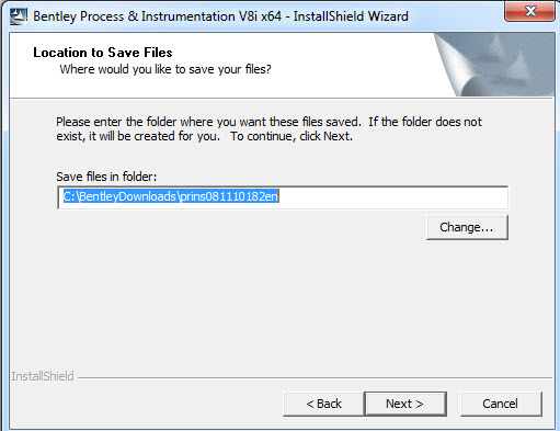

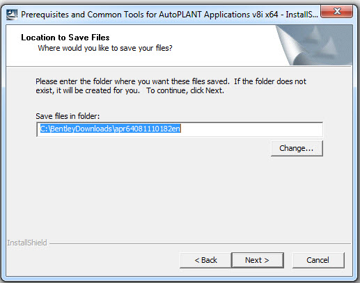

Install File Location Options:
A. Installation files are placed on a network drive and the AutoInstall.bat file is configured to point to and copy the files down to the local C:\BENTLEYDOWNLOADS\ location during the script.
B. Installation files are placed on the local workstation and the AutoInstall.bat runs from this location.
____________________________________________________________________________________
This exercise will follow option B.

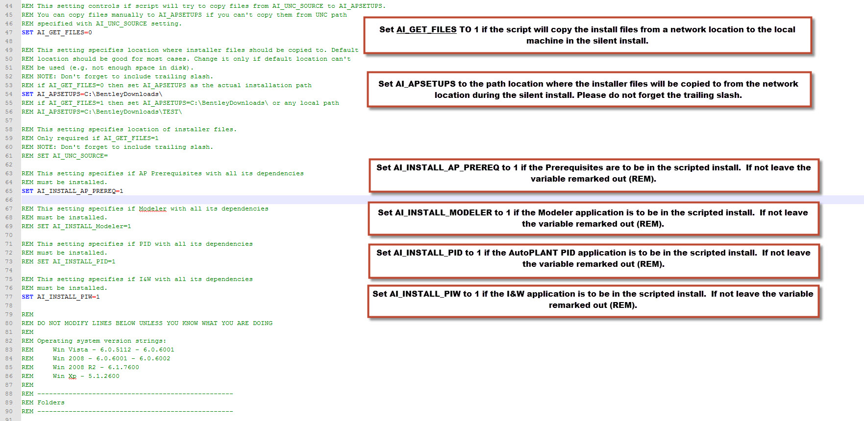

Modification of the AutoInstall.bat file.
In this outline we are only scripting the installs for the AutoPLANT Prerequisites and Bentley I&W applications.
In this example we modified the following variables:
REM This setting controls if script will try to copy files from AI_UNC_SOURCE to AI_APSETUPS.
REM You can copy files manually to AI_APSETUPS if you can't copy them from UNC path
REM specified with AI_UNC_SOURCE setting.
SET AI_GET_FILES=0
REM This setting specifies location where installer files should be copied to. Default
REM location should be good for most cases. Change it only if default location can't
REM be used (e.g. not enough space in disk).
REM NOTE: Don't forget to include trailing slash.
REM if AI_GET_FILES=0 then set AI_APSETUPS as the actual installation path
SET AI_APSETUPS=C:\BentleyDownloads\
REM This setting specifies if AP Prerequisites with all its dependencies
REM must be installed.
SET AI_INSTALL_AP_PREREQ=1
REM This setting specifies if I&W with all its dependencies
SET AI_INSTALL_PIW=1
