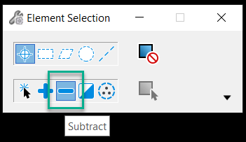

2. In the Selection Menu, hit Select All option. This will highlight all visible elements in the model space.
3. In the same Menu, apply Subtract option to the required elements. (subtract elements in the middle of the screen where you existing model is) This will make the selection solely for the unwanted elements.
4. Lastly, hit the Delete button on your keyboard.
