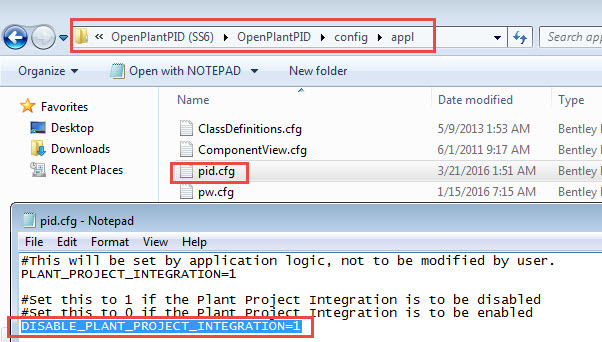

One is to Edit pid.cfg file from "C:\Program Files (x86)\Bentley\OpenPlantPID (SS6)\OpenPlantPID\config\appl" and change "DISABLE_PLANT_PROJECT_INTEGRATION=0" variable value to 1.

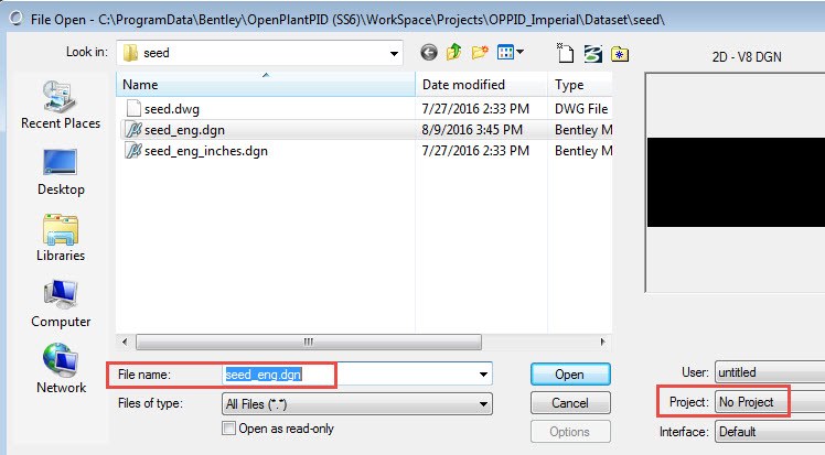

And second is to use “No Project” option while opening Seed file in OpenPlant PID.
  1. Go to "C:\Program Files (x86)\Bentley\OpenPlantPID (SS6)\OpenPlantPID\config\appl" and edit pid.cfg file to change "DISABLE_PLANT_PROJECT_INTEGRATION=0" variable value to 1. Save the changes,

    Launch OpenPlant PID and select No project while opening Seed File
  2. Open Seed file of any project say OPPID_Imperial in OpenPlant PID

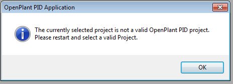

  3. A message will pop up in case No Project option is selected. Press OK to the prompt message to continue

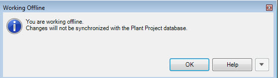

  4. Press OK to working offline prompt message

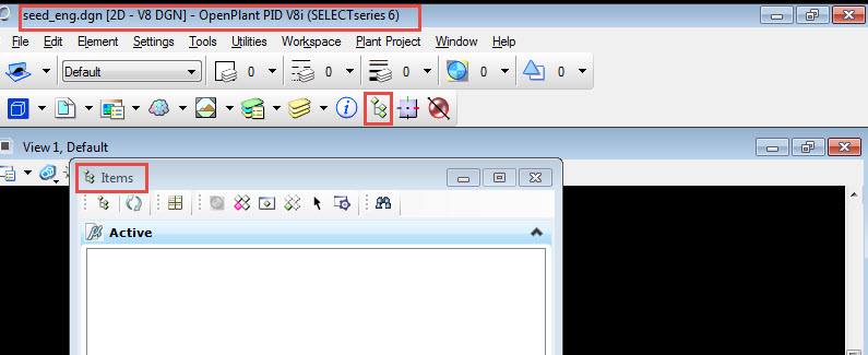

  6. Launch Item Browser and confirm Seed file is not a PID Document

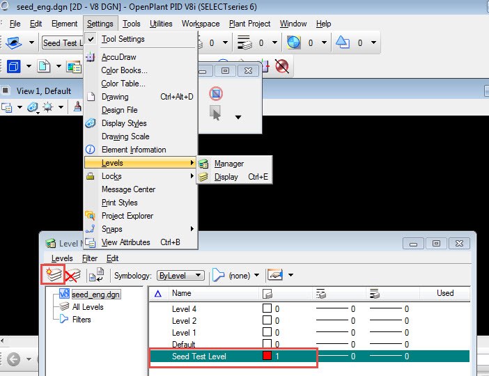

  7. Do the required changes, for example Add a Level by launching Level Manager from Settings -- Levels
  8. Save the changes from File menu and exit OpenPlant PID

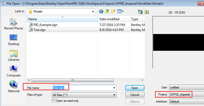

  9. Now relaunch OpenPlant PID and open drawing in same project for which Seed file is changed

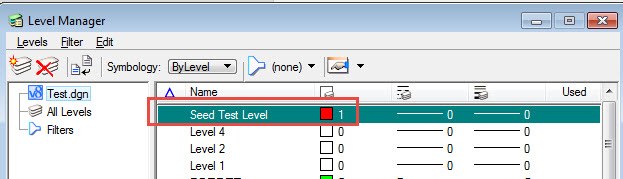

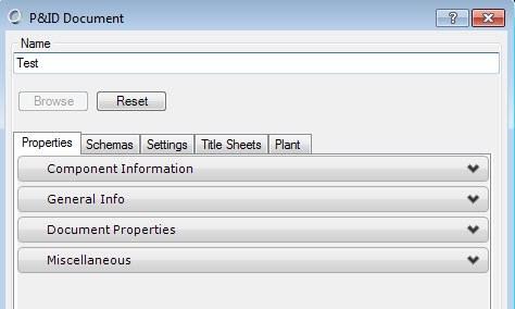

  10. Confirm that PID Document dialog pop up this time. Press OK to dialog

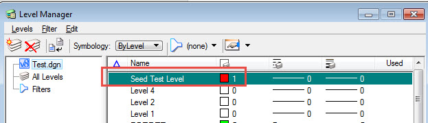

  11. Go to Settings – Levels – Level Manager and confirm that new Level is shown correctly
