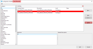

  1. Before creating the regression line from rail, change the linear stroking value.
    From File>Settings>Configuration>Configuration Variables, search "stroking" and edit the variable.
    Set the value to a number greater than the minimum distance between the survey points.
  2. Create the regression line from rails
  3. Delete the variable
    Don't be afraid, you only delete its setting from your personal file settings
