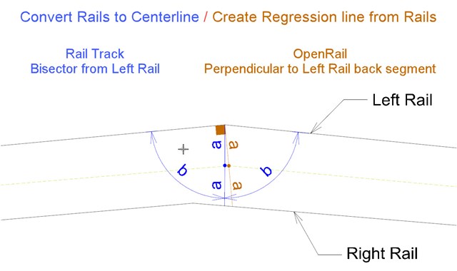

This is to clarify how centerline points are created from rails in OpenRail Designer and Rail Track.
It is slightly different.
Both are using left rail as a reference to create segment that intersects opposite rail.
Rail Track is using bisector line, whereas OpenRail Designer is using perpendicular from back segment.

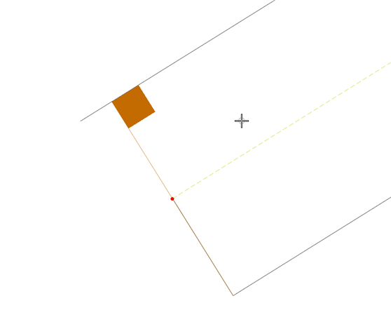

At first point OpenRail is dropping opposite Rail when required:

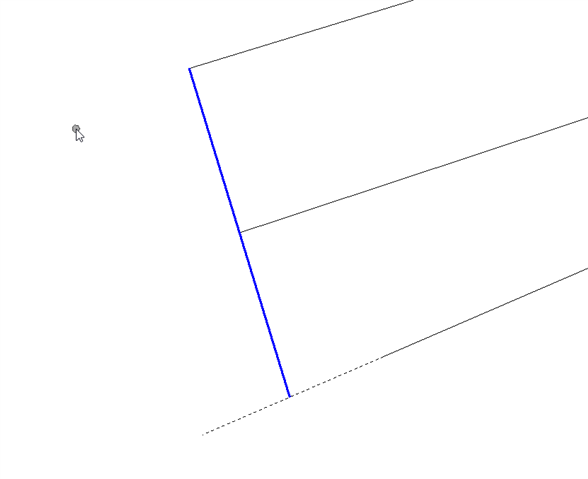

Whereas Rail Track is creating a perpendicular to left rail to intersect an extension of opposit Rail:
