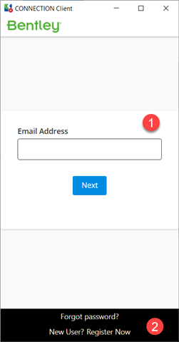

- Sign into Bentley’s CONNECTION Client on computer with your account credentials (also found in software centre if not already installed).
- If not already registered, users should click on the ‘register’ now link in the Client.
