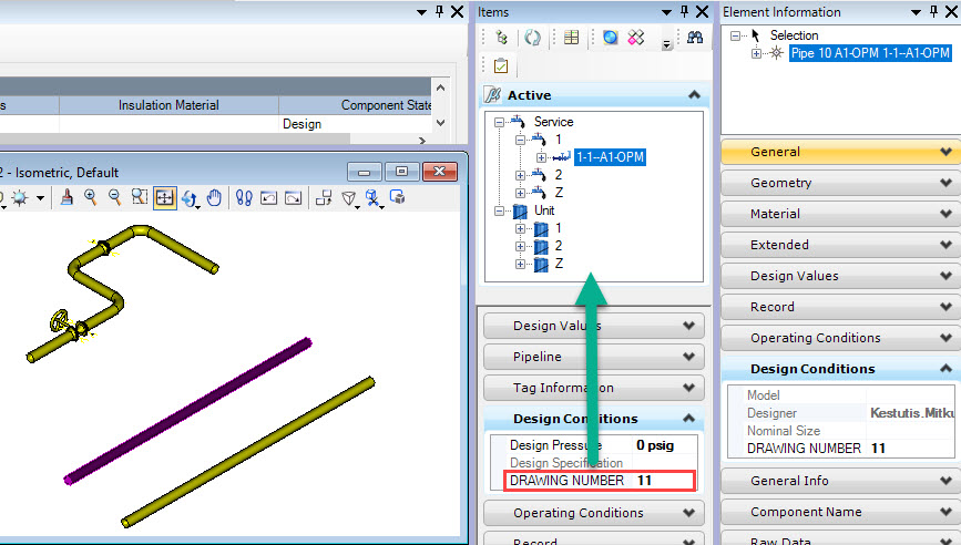

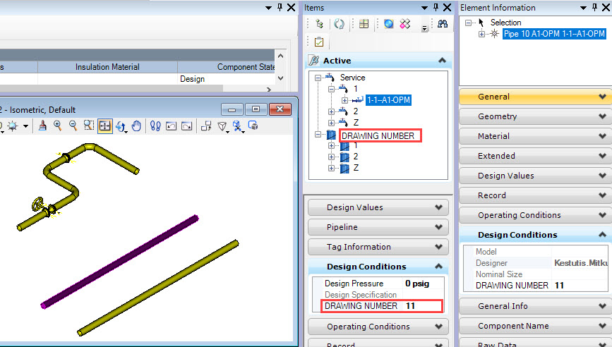

After adding additional property to required classes User waned to list all Pipelines or components by this property in Item Browser.
In this example a new Property DRAWING NUMBER was created.

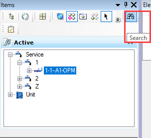

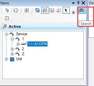

  1. Click on Search icon in Item Browser

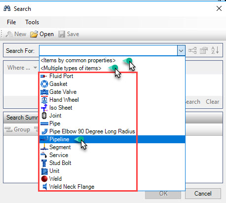

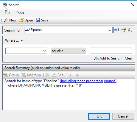

  2. Select to open "Search For" dropdown list and select what is required to search for

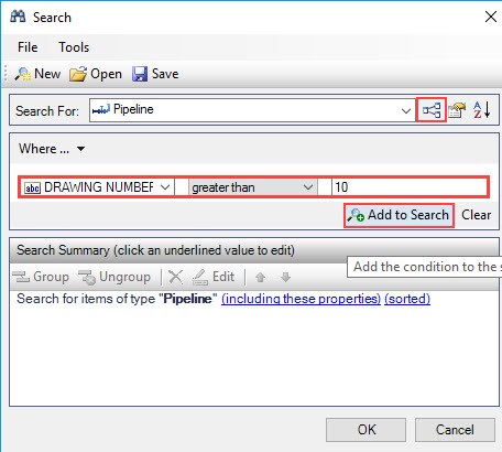

  3. Select a required Property, the Condition and a Value of this search query.
    Click to add this query to Search
    In this Example we would like to list items which has DRAWING NUMBER priority greater than 10

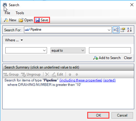

  4. Save this query if there is requirement to use it in future and Click OK button.

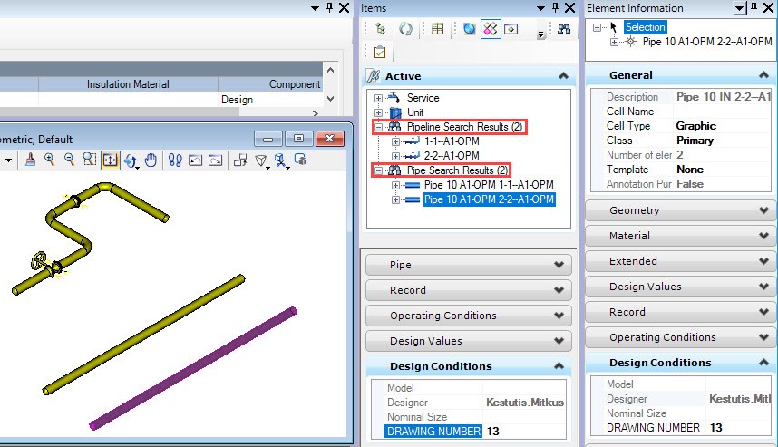

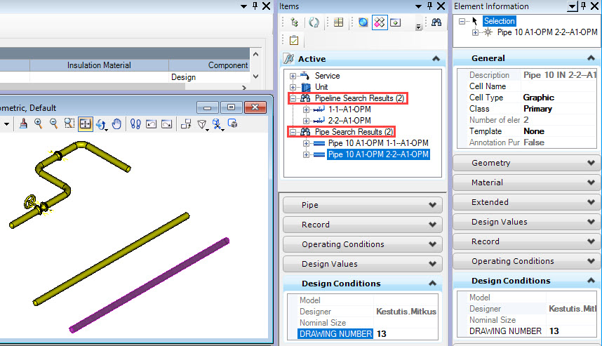

  5. After these steps a new Search results section with required Items will be created. In this example we got List of those items, which has DRAWING NUMBER priority value greater than 10.
