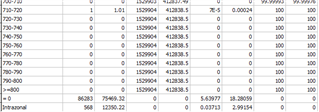

A different approach is used in the third example, with an explicit script outputting the table below:
This contain a separate accumulation and reporting of customized values, in this case null values and intrazonals (I=J). The script contains the following blocks:

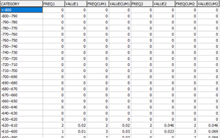

The last example is a generalization of example Ex3, considering more than one accumulation matrix, in particular, two in this case.
