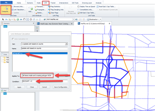

Step 3. Perform the link calculation with criteria for links inside the polygons
- Under the “Link” ribbon under “Link Data” click on “Compute” and express your condition as below (or any condition you like based on link attributes). NOTE: you need to select under “Applies To” the sub-selection of links based on the polygons, you have a few options (inside, outside, inside and crossing, etc.)

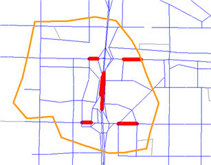

The below are the updated links in the example:
