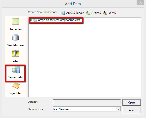

Click on the Add Data button in GIS Window toolbar.
Select Server Data on the left of the file explorer window. This should list the ArcGIS servers available on your network. This should also include the ArcGIS online services. If you do not have access to this, then you need to work with the appropriate department to gain permission, e.g. IT department.

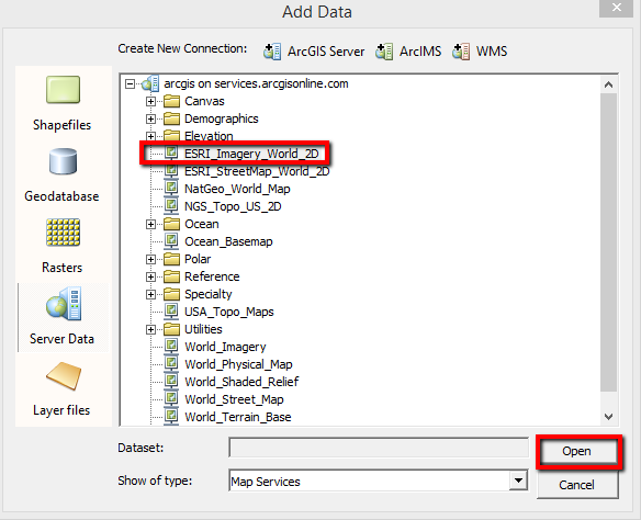

Expand the ArcGIS online services item and select the background layer you would like to add to the highway network layer. Click Open.
The background map should now be added to your network window.
