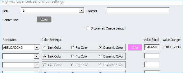

1. Click on Analysis > Multi-Bandwidth…
2. Select ABSLOADCHG as Attribute and Dynamic Color

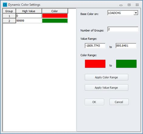

3. Then Click on the Color box and select fields as below using LOADCHG for “Base Color On”

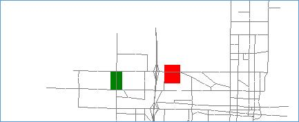

4. In the example, only two links changed.
