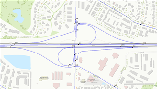

1. For the first half of the article, we will focus on the GIS Window. Load any highway network from a CUBE database. The example below is of Cubetown with Esri topo map in the background.

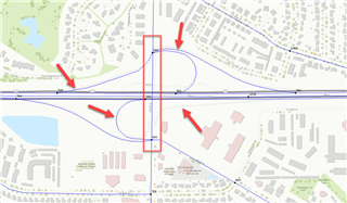

2. Begin an Edit session. For this example, modifications were made to the areas in red.

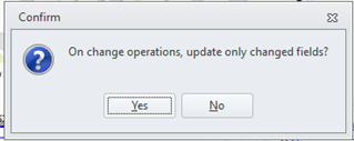

8. Confirm the operation so it commences.

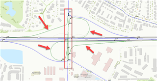

9. You should receive a window similar to this if the log ran correctly. Click OK twice to close the update windows.
10. The new links will be a different color than the original links. But once you save the edits to finalize the changes, all the links should be the same color.

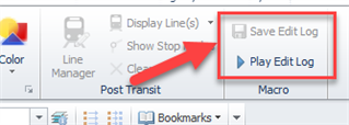

11. In the Network Window, you can perform the Save Edit Log and Play Edit Log actions in the same area as before (Home tab > Macro section).
12. By repeating the same methodology of the GIS Window for the Network Window, the same results can be achieved.
