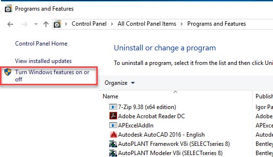

  1. Search for "Turn Windows features on or of"
    or open Programs and Features dialog and select it from there
  2. In This dialog mark .NET Framework 3.5 checkbox and click OK

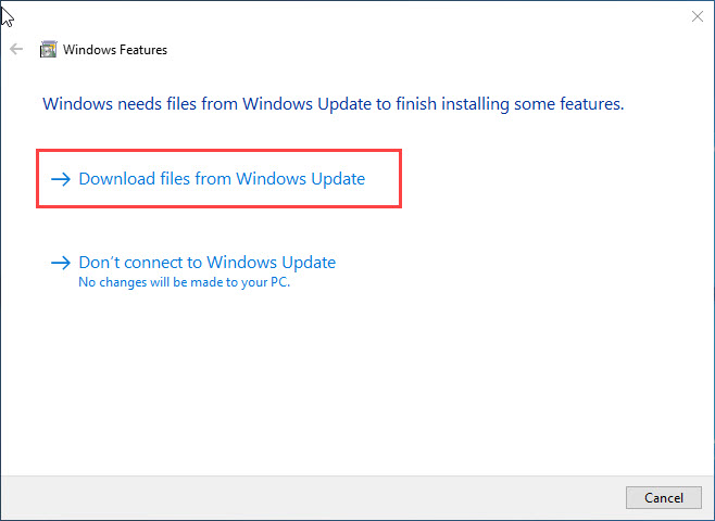

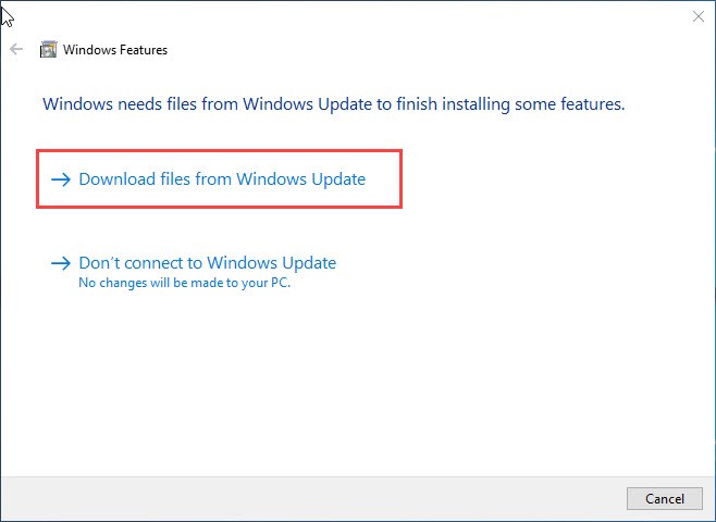

  3. Then select to Download files from Windows Update

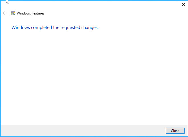

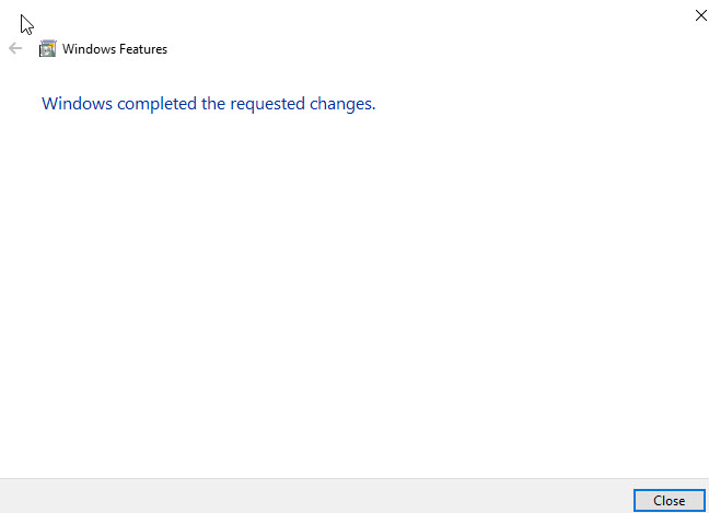

  4. Windows will download and install selected .NET Framework 3.5
  5. After successful NET Framework 3.5 installation you can start Prerequisites and Common Tools for AutoPLANT Applications installation again and it will add missing Bentley Class Editor. AutoPLANT Modeler will be allowed to install as well.
