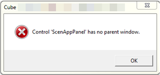

If you are receiving an error 'Control ScenAppPanel' has no parent window as below:

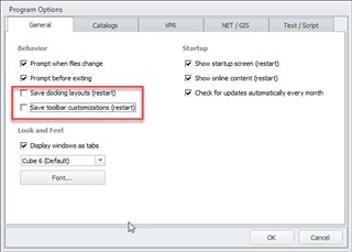

Please go to File > Options and uncheck the two options below. Re-Start Cube and the issue should be fixed. NOTE: This step also fixes the missing ribbon issue.
