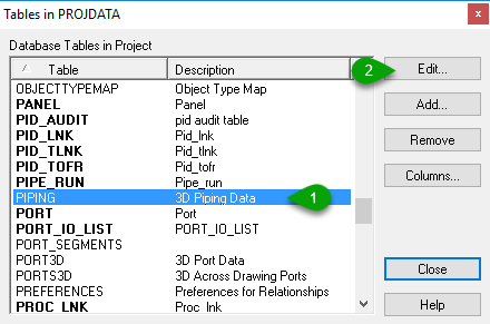

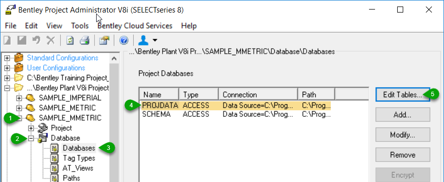

  1. Launch Project Administrator.

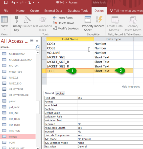

  2. As per the mentioned steps in the below screenshot edit the PROJDATA table.

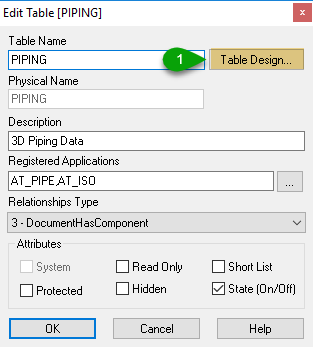

  3. Scroll Down to the Piping Table, highlight it and Press the Edit button.
  4. Select Table Design.
  5. Add required field to the Table.  The field Properties from most descriptive data can be set to match the Piece Mark field properties.

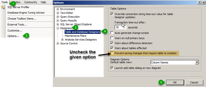

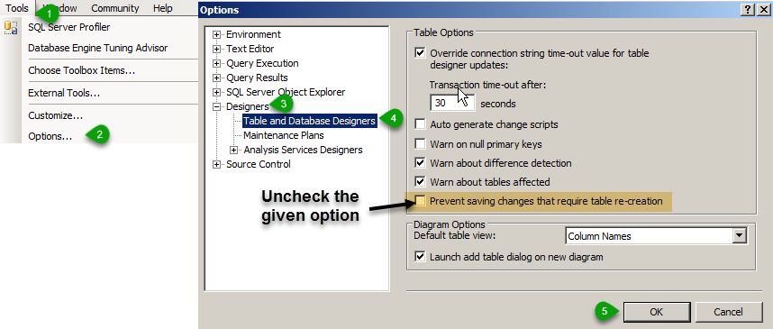

  1. Before editing any table make sure to uncheck the Prevent saving changes from options as per below screenshot.
    once unchecked, the changes made can be saved.

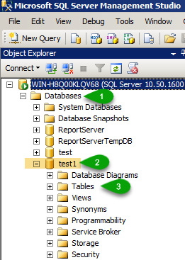

  2. Open Microsoft SQL Server Management Studio open the required Database to add the new field in the selected Table. (The below mentioned screenshot show the required changes to be carried in the test1 Database)

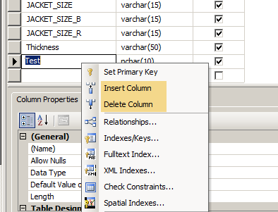

  3. Expand the Tables field and scroll down to the PIPING Table right click on PIPING Table and select Design as mentioned in the below screenshot.

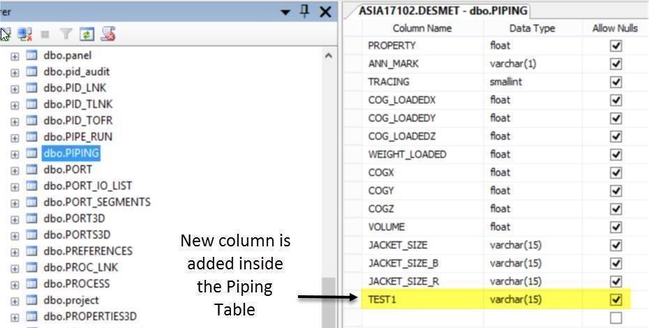

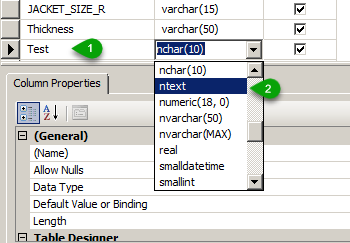

  4. Put the Column name as shown in step 1 and Data type in step 2 as per user requirement.

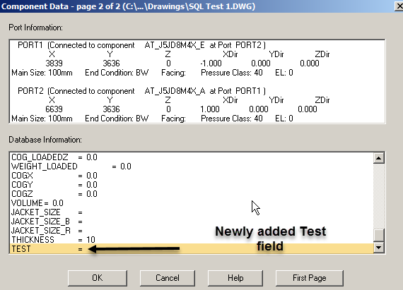

  5. Check in the Piping Data field and found that new Test field is added in the component data.

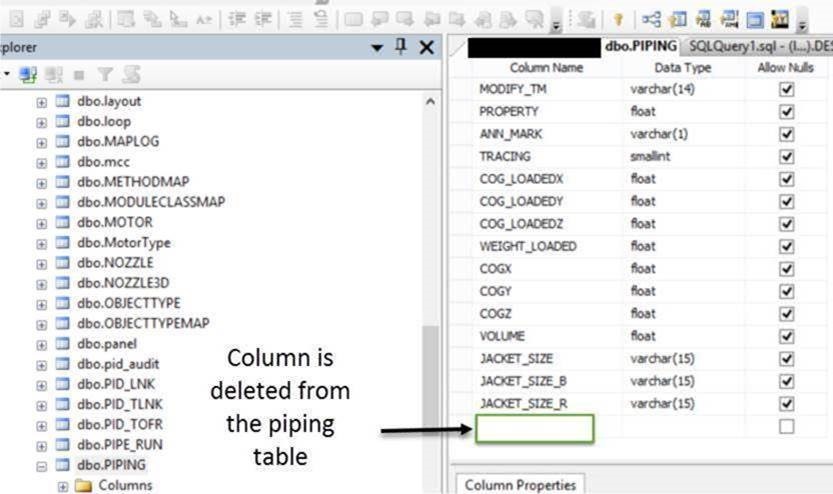

    Steps to delete any field
  6. Open the required field by following the above-mentioned steps 2 & 3.
  7. Right click on the field and below dropdown window for more editing options.

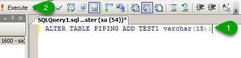

To create the new queries in SQL Server Management Studio kindly refer the below steps to add and modify the queries.
  1. Open SQL Server Management Tool.
  2. Click on New Query as mentioned in the below screenshot.
  3. Run the query “ALTER TABLE PIPING ADD TEST1 varchar(15);” in the query tab to add a new column in the piping table and click Execute. Please find the below screenshot for your reference.
    once the above mentioned query is executed the new column is added in the Piping Table as mentioned below.

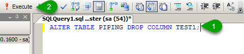

    Deleting a column (TEST1) from the Piping table.
  4. Open SQL Server Management Tool.
  5. Click on New Query as mentioned in the below screenshot.
  6. Run the query “ALTER TABLE PIPING DROP COLUMN TEST1;” in the query tab to delete TEST1 column from the piping table and click Execute. Please find the below screenshot for your reference.
    ones the above mentioned query is executed the new column is deleted from the Piping Table as mentioned below.
Updating Previously Created Components
Although all components created from this point forward will automatically be populated with the new data, previously created components will need to be updated.  Running the command Piping>Database Tools>Update From Spec should take care of the update.
