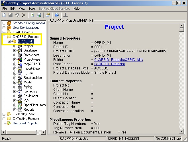

  1. With Bentley Project administrator add OpenPlant PID Project's root and create new Project.

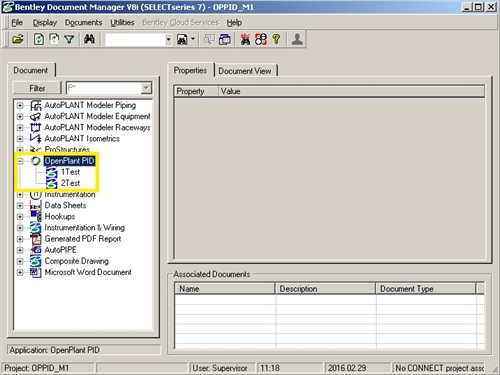

  2. Open Document Manager or Vision and in this Project create new OpenPlant PID drawing.

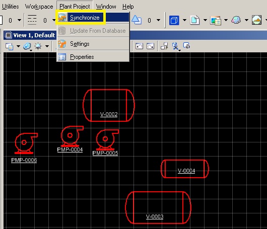

  3. Add required components and synchronize drawing with Plant Database.

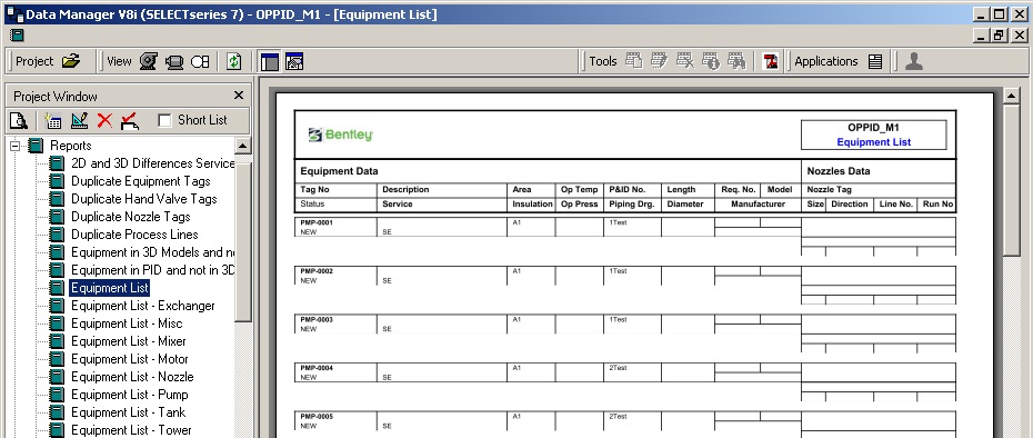

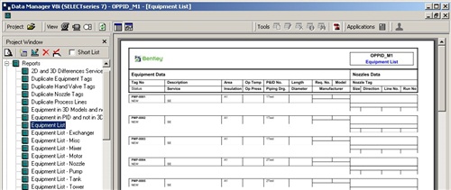

  4. In Data Manager open required Report and verify results.
As well you can import required Reports from other Projects
  1. Select create new report and in "Create New Report" dialog select "From Other Projects".
  2. Select from which Project and chose required Report.
  3. Open imported Report and verify results
