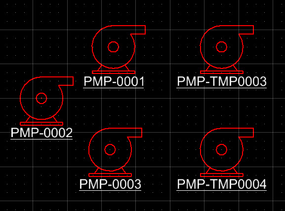

This article will explain the procedure of including special property in component Tag Information. User has the Pump tag defined as DEVICE_TYPE_CODE-NUMBER, but there is request to add "TMP" - temporary group characters only to required component Tags. By default if property is included in TAG it will be always added, but in this case user request is to have choosing possibility: place a temporary component tag or final one. This might be required for some design situations, when temporary tags are updated in later time directly from database or Data Manager.

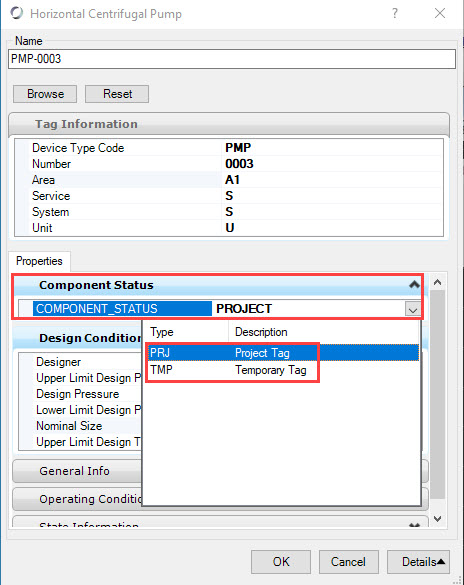

  3. In Equipment class create new property COMPONENT_STATUS.
  4. Add required Custom Attributes with values as in picture below.

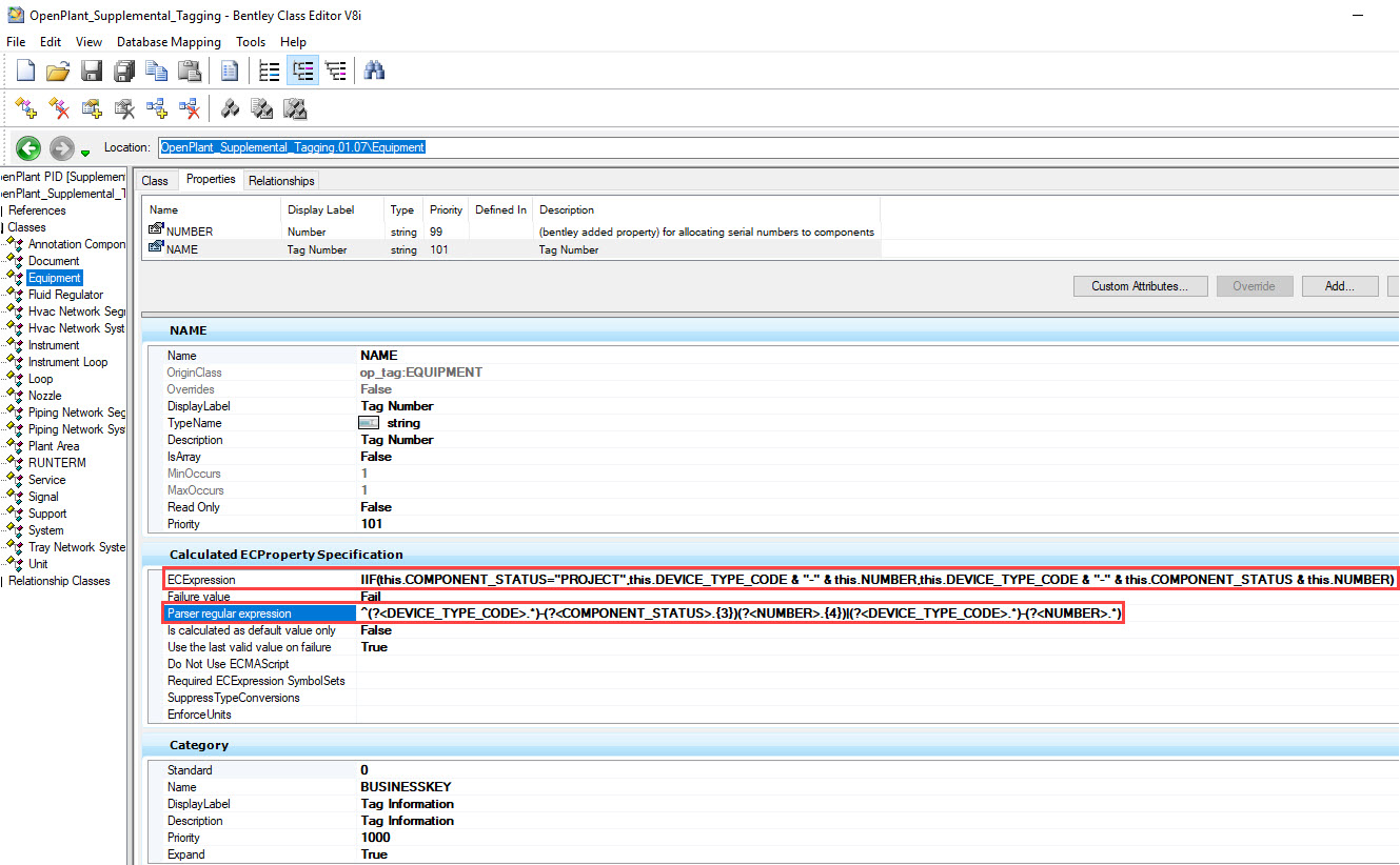

  5. Now open OpenPlant_Supplemental_Tagging.01.07.ecschema.xml, go to Equipment class NAME property and change the ECExpression to this:
    IIF(this.COMPONENT_STATUS="PROJECT",this.DEVICE_TYPE_CODE & "-" & this.NUMBER,this.DEVICE_TYPE_CODE & "-" & this.COMPONENT_STATUS & this.NUMBER)
    Parser regular expression to this:
    ^(?<DEVICE_TYPE_CODE>.*)-(?<COMPONENT_STATUS>.{3})(?<NUMBER>.{4})|(?<DEVICE_TYPE_CODE>.*)-(?<NUMBER>.*)
  6. Save the changes in both schemas and close them.

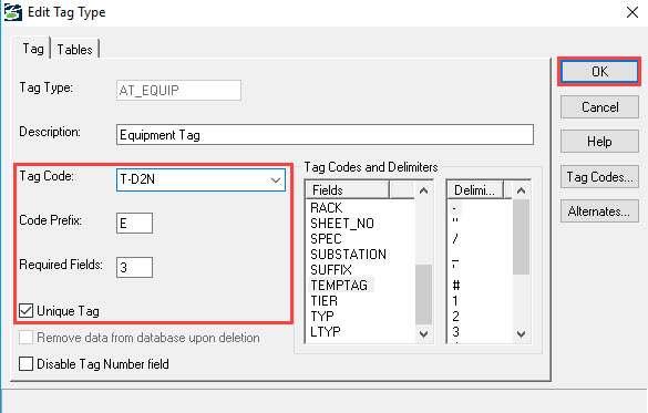

Create new Tag Type in Project:

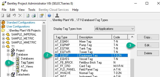

  1. Launch Project Administrator, expand the <Project Name> node, expand Database node and select Tag Type
  2. Select Equip tag type and click Edit.

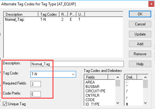

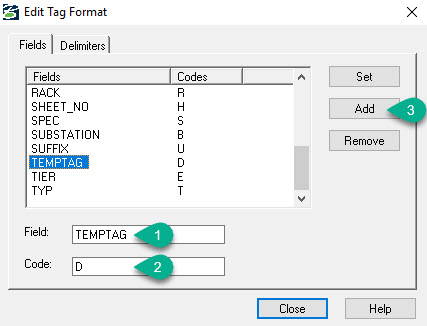

  3. Create new Alternate as in picture below
  4. Create new Tag Code as in  picture below

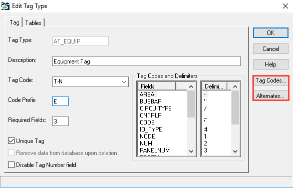

  5. Finish editing AT_EQUIP tag as in picture below

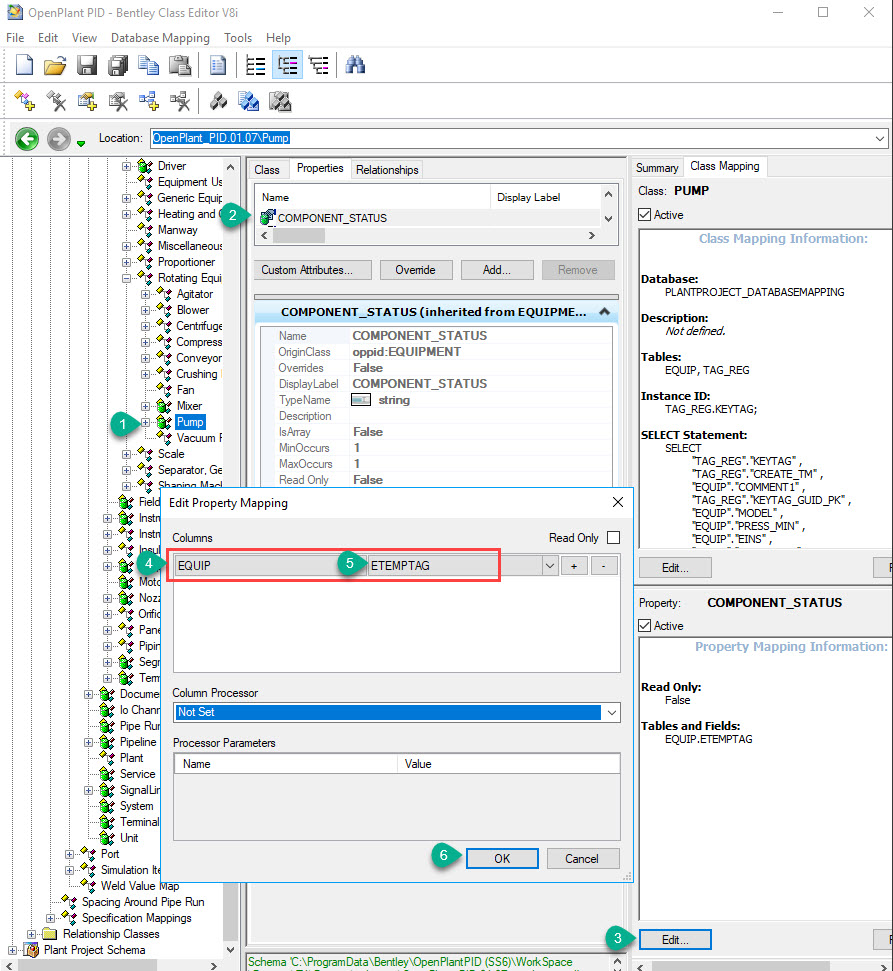

Add mapping in schema:
In this wiki article you can find instruction how to map a custom/existing EC property with Database field.
communities.bentley.com/.../how-to-map-custom-properties-with-database
Check "B. Add mapping in schema" section and fallow the steps to map required property with new database field.

  1. Select to place anew Pump and you will see new Component Status sections in which you can choose component type - temporary or project.
