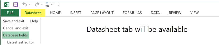

The user wants the Datasheets tab to be present in the generated datasheet. This option must by default be present when the isometric is generated.

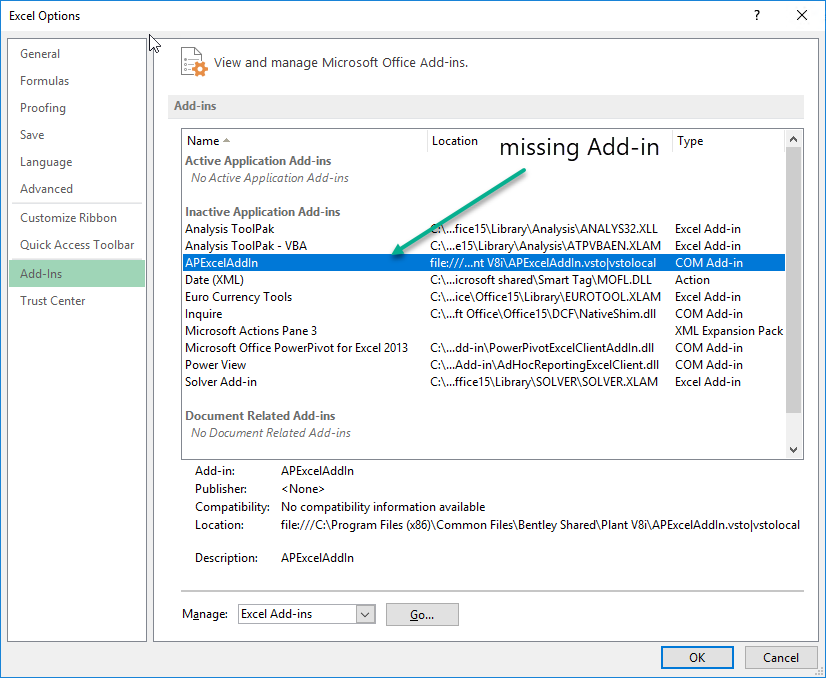

This occurs because APExcelAddin is not installed while installing AutoPLANT Modeler in the machine because of permissions issue.

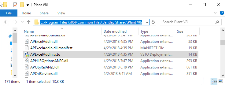

  1. Open Windows Explorer.
  2. Navigate to the path C:\Program Files (x86)\Common Files\Bentley Shared\Plant V8i.

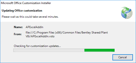

  3. Double click on ApExcelAddIn.vsto file to install it.
  4. Now, if we generate a new Datasheet the required tab will be available.
