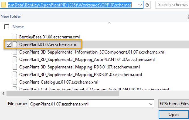

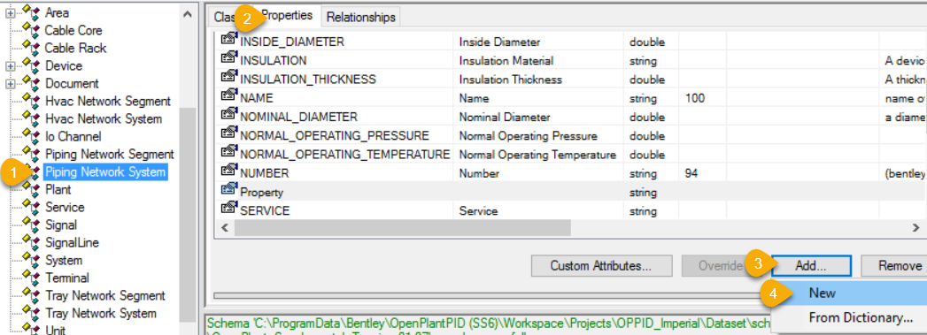

  1. Launch Class Editor.
  2. Open OpenPlant.01.07.ecschema.
  3. Supplement with OpenPlant_Supplemental_Tagging.01.07.ecschema.

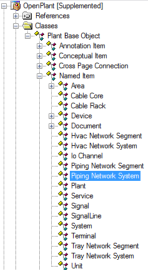

  4. Select Piping Network System class.

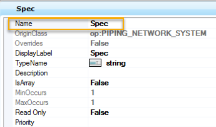

  5. Switch to Properties Tab and ADD.
  6. Edit property name, refer below image here Spec.

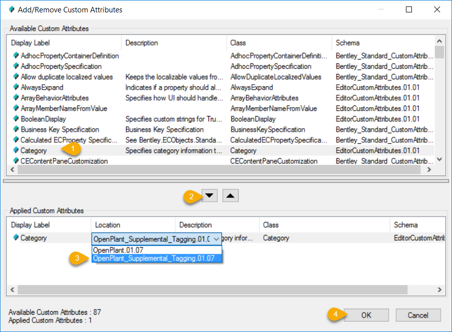

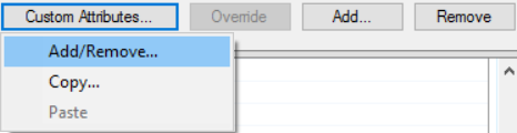

  7. Click on Custom Attribute > Add for adding Category custom attribute.

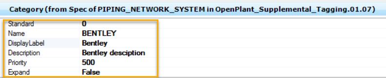

  8. As per requirement fill data in Category, refer below image.
    Note: Fill all complete data mention under Category.
              Name should be on capital letters.
  9. Save all settings.

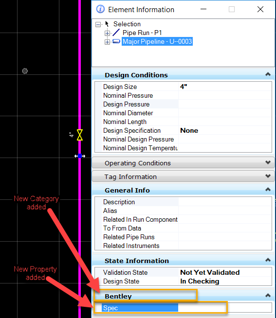

  10. Launch OpenPlant PID & Verify results.
