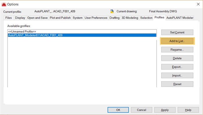

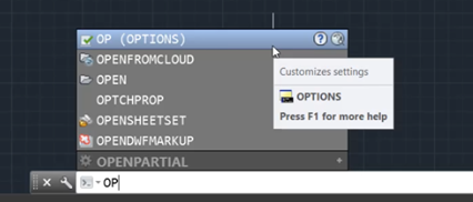

3. Open the AutoCAD shortcut and type "OPTIONS" in command tab or go to "Tools>Options...''
4. Check what the 'Current Profile:' is, and click on Add to List tab.

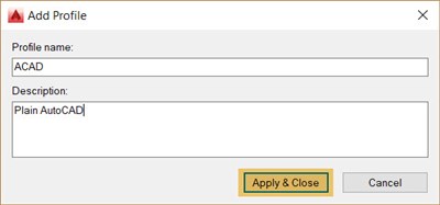

5. Enter the "Profile name", "Description" as per requirements and click on Apply & Close.

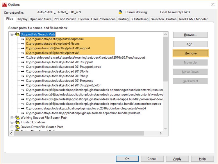

6. Now, click open "Files" tab and if you see the paths,remove the following 4 Support File Search Paths: -
          a) C:\ProgramData\Bentley\Plant V8i\apmenu
          b) C:\ProgramData\Bentley\Plant V8i\icon
          c) C:\ProgramData\Bentley\Plant V8i\support
          d) C:\ProgramData\Bentley\Plant V8i\
Click on Apply and OK tab.

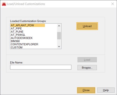

7. Now type "MENULOAD" in the command tab and press Enter.
8. From the Load/Unload Customizations > Select "AT_APLANT_PDW" and Click on Unload > Close .
9. Save and Close the AutoCAD application.

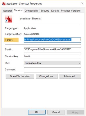

B] Setting the AutoCAD Icon to load specific profiles
Sometimes AutoCAD will keep calling one of the AutoPLANT profiles when attempting to just load plain AutoCAD from the AutoCAD icon. This is because AutoCAD has a tendency to load the last used profile. if the user used AutoPLANT last, then the AutoCAD icon will attempt to load that profile rather than the default AutoCAD one. Follow the below steps to force the AutoCAD Icon to load a default profile. Note that these steps call the Unnamed Profile , which is AutoCAD's default profile, or a user can use any profile they wish for this, but they will need to point to program to the path of the profile's file. It is recommended that the user looks over how the Profiles are called out for the AutoPLANT Icons. They point to paths rather than a Profile name like the below steps do.

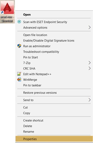

10. Right Click on the shortcut of AutoCAD >Go to Properties.
11. Look at the ˜Target:' field, it should contain the path to the acad.exe which will vary depending on what AutoCAD version being used.

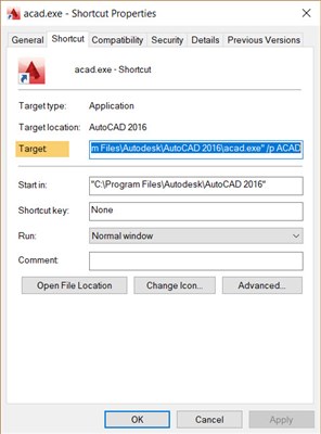

12. The Default target should look like this:-  C:\Program Files\AutoCAD 2009\acad.exe" 
13. Now at the end of the default target add the following - /p "ACAD"   {i.e.- (space)/p(space)"ACAD"}. The Final Target should look like this - C:\Program Files\AutoCAD 2009\acad.exe" /p "ACAD"
14. After adding this, load up AutoCAD, it should now force load the "ACAD" which is AutoCAD's default profile
