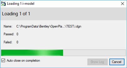

I-model doesn’t load in OpenPlant Isometrics Manager. Progress bar in below dialog doesn't move further beyond this point and the process goes into loop.

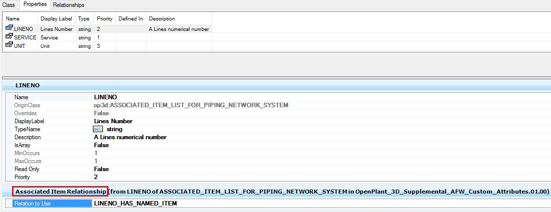

User has created a new associated item for pipeline as “Lines Number” refer image below.
Also, "Associated Item Relationship" custom attribute for this item is defined in supplemental schema as shown below.
NOTE: The schema location for this custom attribute (Associated Item Relationship) must be in OpenPlant_3D.01.07 schema. Similarly check other classes like ASSOCIATED_ITEM_LIST_FOR_EQUIPMENT, ASSOCIATED_ITEM_LIST_FOR_HVAC_NETWORK_SYSTEM etc. and make sure that the above mentioned custom attribute is placed in primary schema only which is OpenPlant_3D.

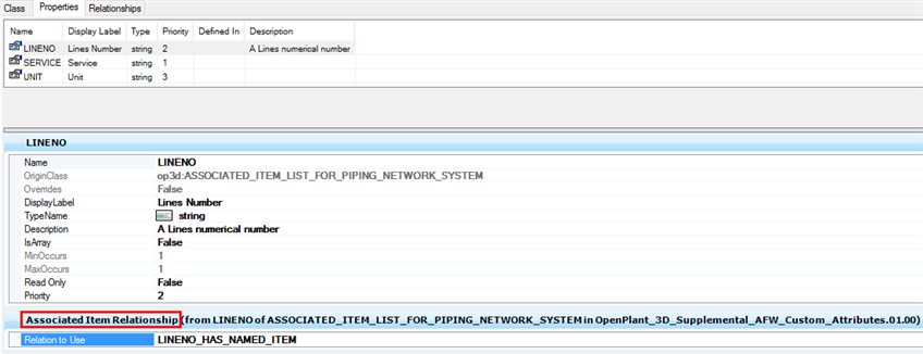

  5. Navigate to ASSOCIATED_ITEM_LIST_FOR_PIPING_NETWORK_SYSTEM class, switch to properties tab as shown below.
  6. Select newly associated item, here “LINENO” & scroll down to Associated Item Relationship custom attributes. Notice that schema location defined for this property is not in OpenPlant_3D as shown.
  7. Click on LINENO & select Custom Attributes > Add/Remove as shown below.
  8. Change schema location to OpenPlant_3D.01.07 as shown below.
  9. Save all the changes.
