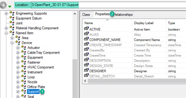

  3. Navigate/Go to SUPPORT class.Switch to Properties tab as shown below.

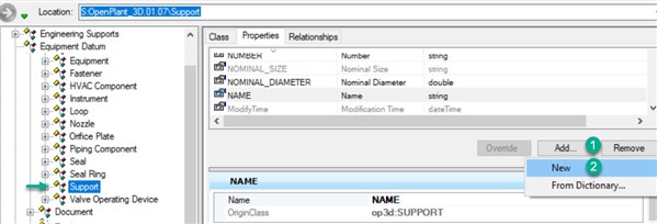

  4. Click on Add > New to create a new property. Refer image below.
  5. Enter property details for newly created property as shown below.

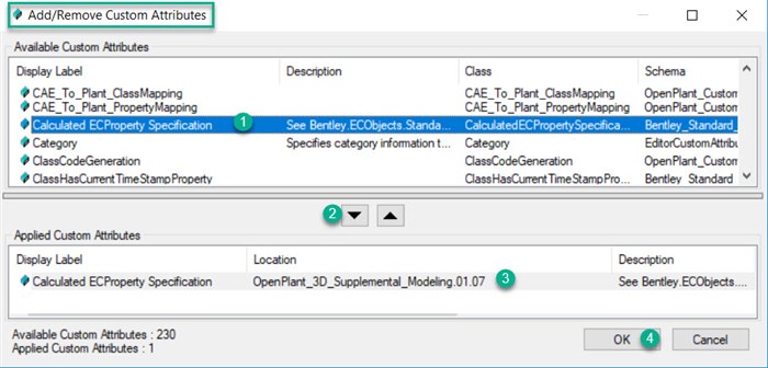

  6. Right click on newly created property here LINENUMBER & select Custom Attributes > Add/Remove to add custom attribute as shown below.
  7. Search for Calculated ECProperty Specification custom attribute & using down arrow add this custom attribute. Ensure to change schema location for this applied custom attribute as shown below.
  8. Enter details for applied Calculated ECProperty Specification custom attribute as shown below.

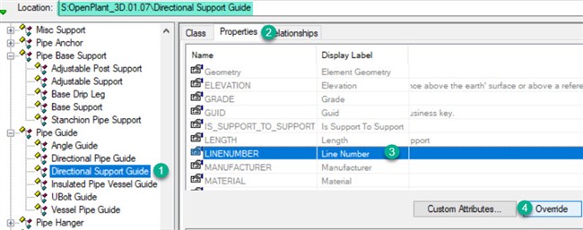

  9. Go to DIRECTIONAL_SUPPORT_GUIDE class, switch to properties tab & search for LINENUMBER Click on Override to localize this property. Refer image below.
  10. Enter details for applied Calculated ECProperty Specification custom attribute as shown below.
    ECExpression: this.GetRelatedInstance("SUPPORT_HAS_SUPPORT:1:SUPPORT").LINENUMBER

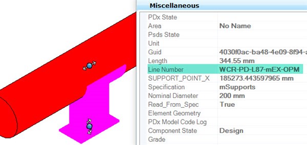

  11. Save all the settings & verify result in OpenPlant Modeler.
    Line Number to Support, here Tee Shoe Pad
    Line Number to associated support element, here directional support guide.
