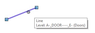

Flyout is a preview box with different information about the item.
When you use the mouse (element selection) to point to an element, different information is displayed.
MicroStation elements are usually the element type and the level.
You can set exactly what is displayed on a mechanical element.
Go to "Workspace - Preferences" and select the "Building Mechanical" category.
Put a tick in front of each option.
