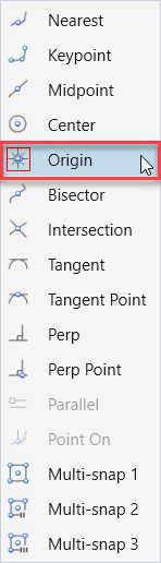

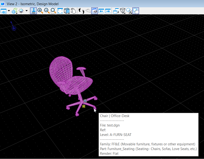

After placing a cell, how to determine the placement point?
1. Change the snap settings to 'Origin'.
2. Simultaneously press Shift+Ctrl and then hover over the cell and you will get the Placement Point.
