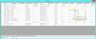

Is there a way to export from Item Browser to Excel?
Yes it is possible to export from the Items dialog box:
1) Select the items you wish to export and select "Show Details"
2) Once the list opens "right click" on one of the items in the list and select "Export to Excel".
You'll be prompted to save the excel file to a desired folder location.
