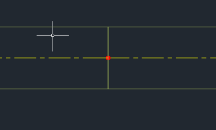

Method 1: Modifying the Weld Size in the AutoPLANT Drawing
Note: The changes will be drawing specific only.

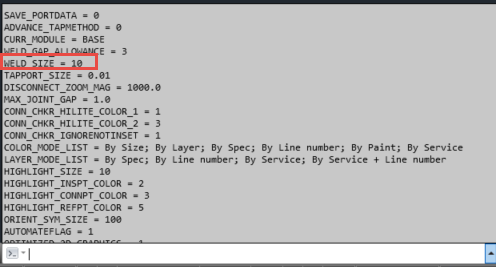

  1. In AutoPLANT Model type in the command line (at_pipingsystem_displayvariables).
  2. In the command line type (at_pipingsystem_setvariable "WELDSIZE" "40").
  3. Notice, now that the weld size has been changed.

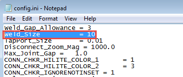

Method 2: Modifying weld size setting to make it project specific
  1. Open Config.ini located at location: %Project_name\Config\Config.ini.
  2. Change the variable Weld_Size to the required value.

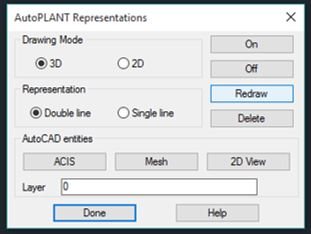

  6. Open Project from Bentley Document Manager
  7. begin to draw pipe

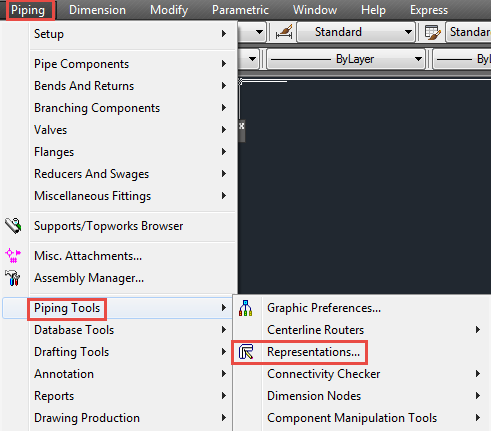

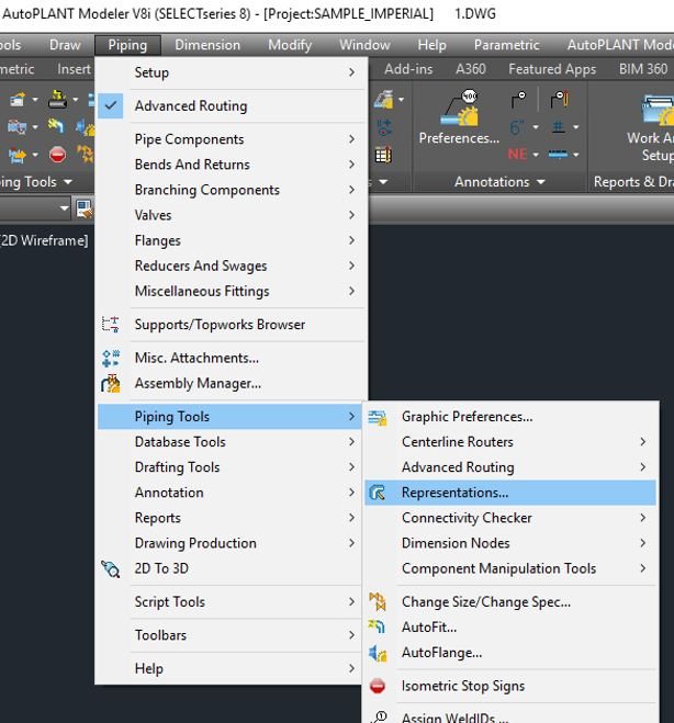

  8. if there is pipe existing that needs redraw
  9. From the Piping Tab: Piping Tools: Representation: Redraw
