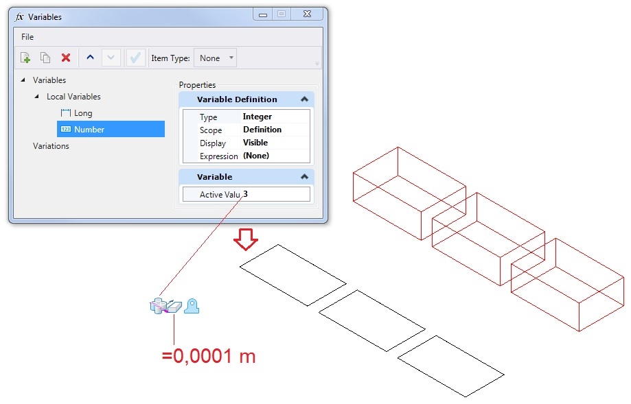

How to create 2D elements array with variable ?
The Array Feature tool is different to the Construct Array tool and only works with 3D parametric solids (won't work with ordinary SmartSolids).
But there are a couple of possibilities to achieve this:
Example 1 :
This can be achieved by creating very thin 3D Parametric Solids

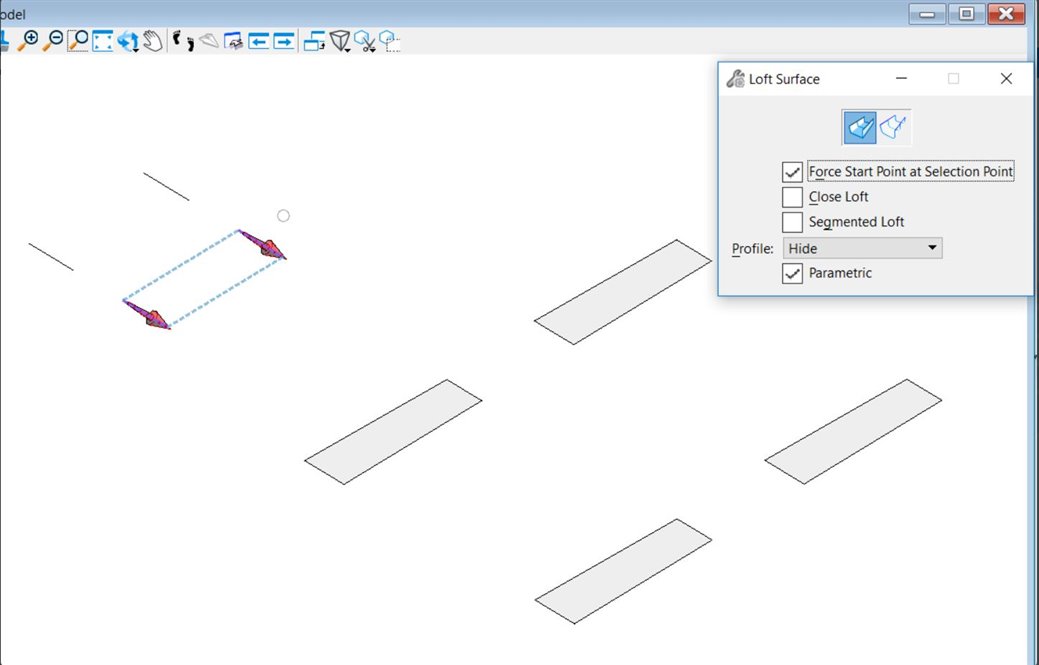

Example 2:
A loft surface can also be parametric and is valid for a parametric array. Variables can be assigned to the two lines and their distance.
