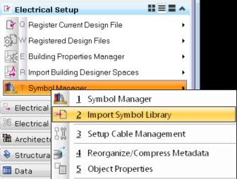

2.4. From the Electrical Setup Task set choose task T2, Import Symbol Library

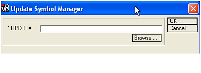

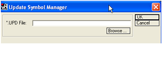

2.5. Update Symbol manager dialog box comes up. Using Browse button navigate to folder "Import ABD Electrical Library"  and select ImportCustomLib.UPD file.
2.6. Following Information will pop up. Click OK

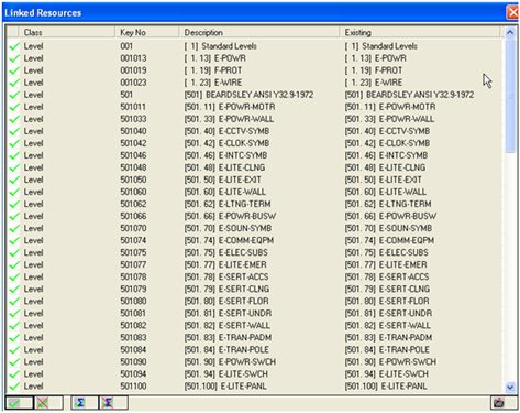

2.7. The linked resources dialog box comes up. Select all entities using green check mark from lower left corner. This dialog box lists all levels that exist in the new library. Levels that are selected with a green check mark will be imported in symbol manager and assigned to proper symbol groups.
2.8. Close Linked resources dialog box.
