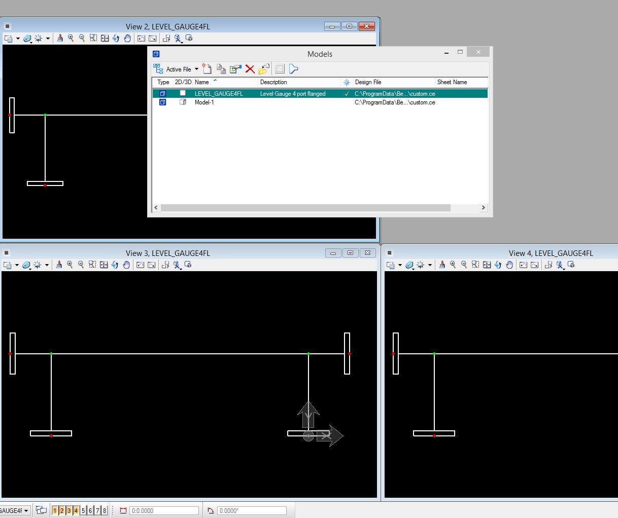

User want to extend the distance between valves in 4 way level gauges symbol. (Level_GAUGE47FL)
Steps to Resolve

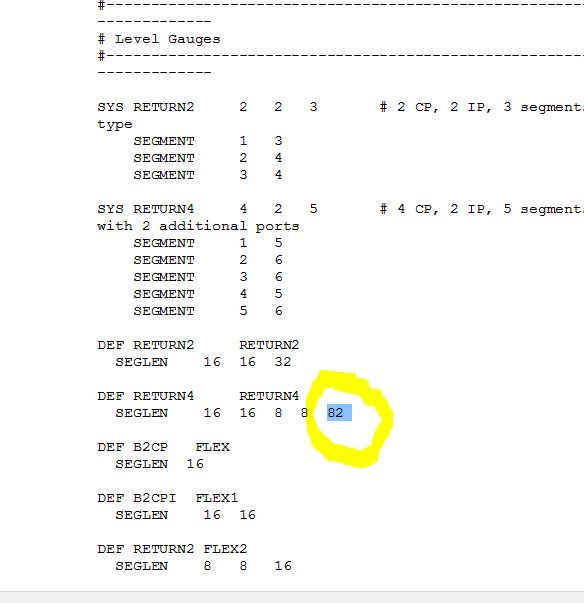

  1. Go to Your Project [...]\Config\OpenPlant\Isometrics\styles\[...]\config and copy the symbolsizes.def as back up

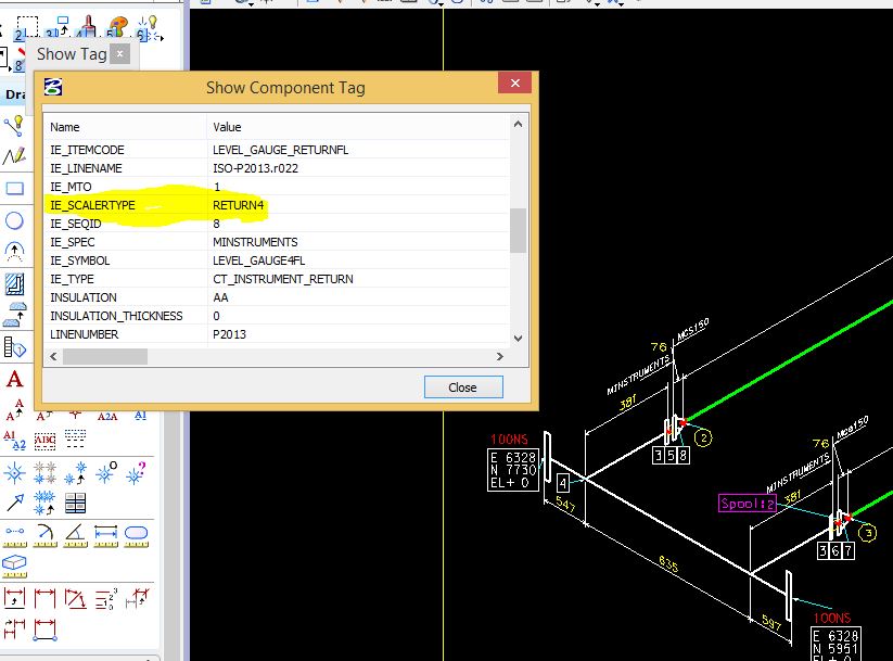

  2. Open the original file and search for RETURN4 (This is the IE_SCALERTYPE of that symbol.)
  3. Edit the component in the definition file as follows
      DEF RETURN2     RETURN2
      SEGLEN    16  16  8  8  82
    (this is an example value of 50)

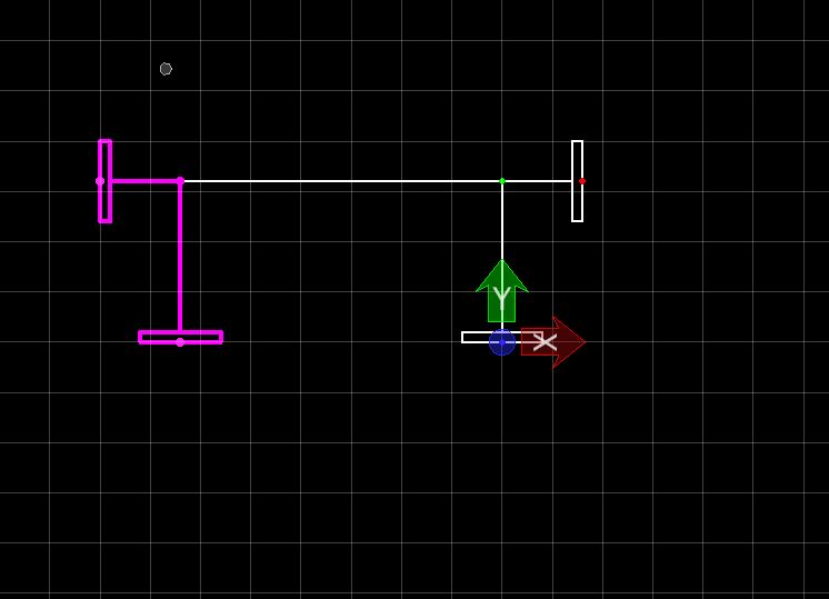

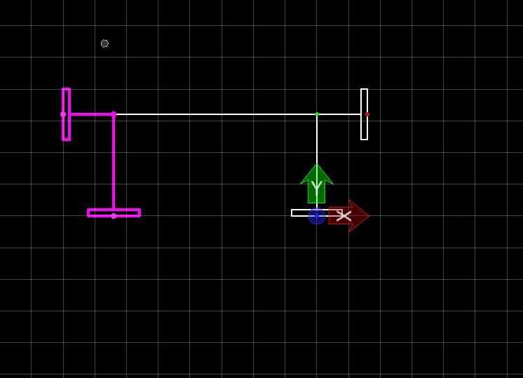

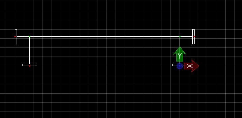

  4. Save the file and go to Your Project [...]\Config\OpenPlant\Isometrics\styles\[...]\cell and open the custom.cel
  5. Import the correct symbol from the lisocomp.cel. (Level_GAUGE4FL)
  6. Now move the selected items 50 (distance) to the left and reconnect the horizontal line

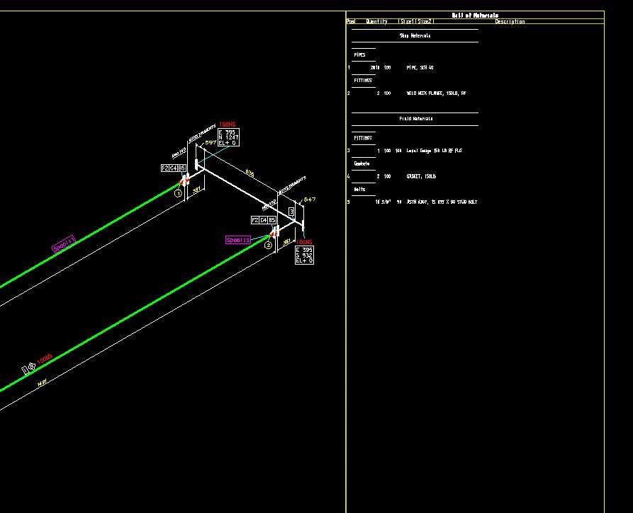

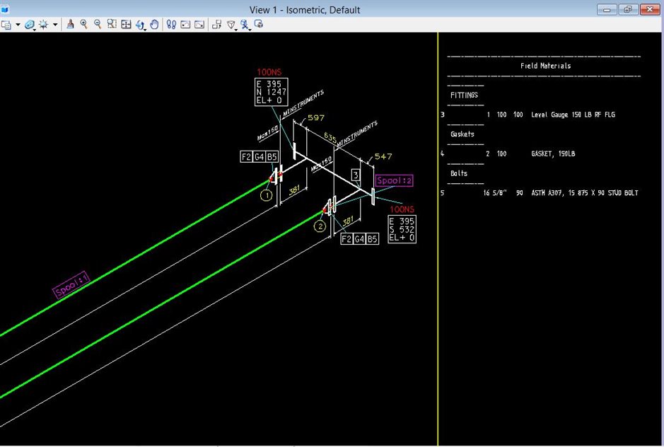

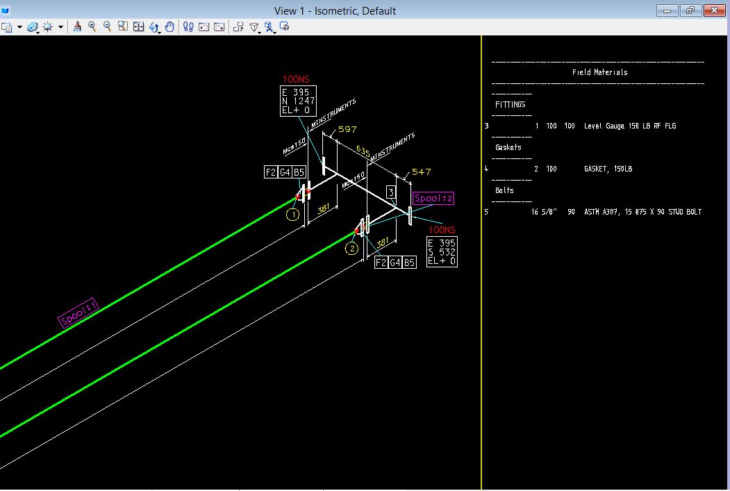

  7. Save the file and run an Iso from a 4 flanged level gauge
