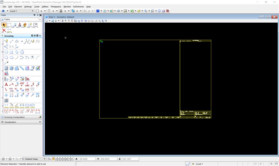

Step I:  Create the Table Graphics in the Isometric Seed file.
For Project Unit  = SAMPLE_IMPERIAL
      Isometric Style = As Built
a) Open Project Administrator  > SAMPLE_IMPERIAL  > OpenPlant Isometrics  > Settings >  Create/Modify  > Advanced > Open Seed File
Seed File is Displayed in this manner.

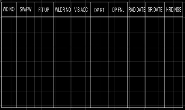

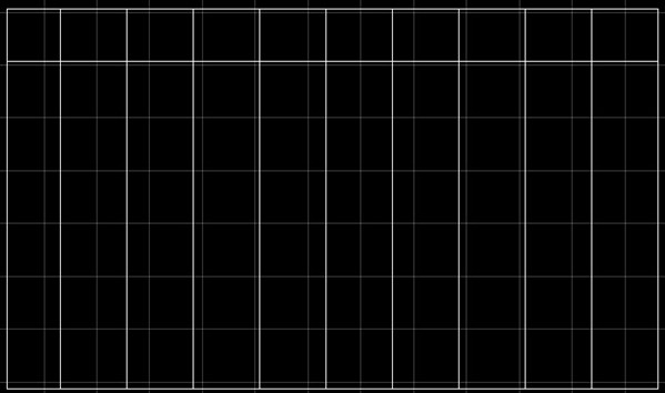

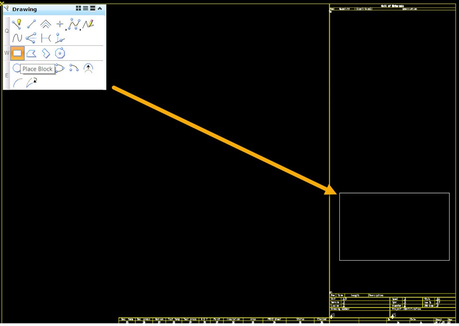

b) Create the Table Graphics as per the requirement of the No. of Columns by firstly using Create block command to create the main block: -
c) Then use Place Smartline Command to create individual columns and the Heading Row: -

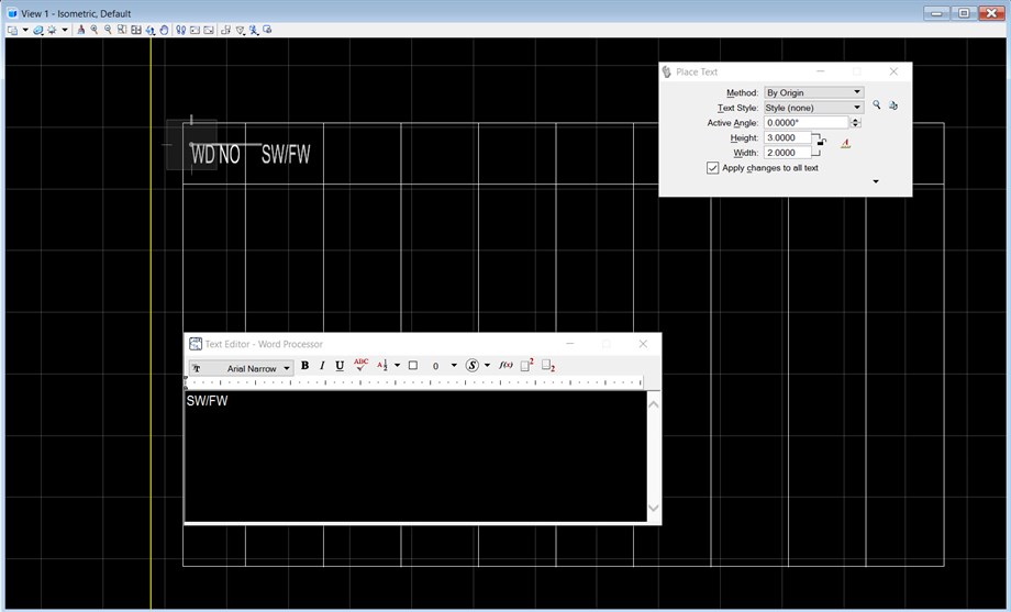

d) Use the Place Text option to place the Names of respective columns of the Report: -
Final Table Graphics should look like this.

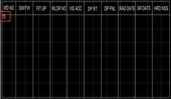

Step IICreate and Assign a Text node to the report.

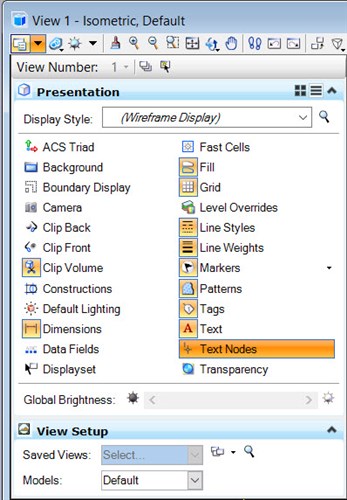

a) Activate Text Nodes from the View Attributes.

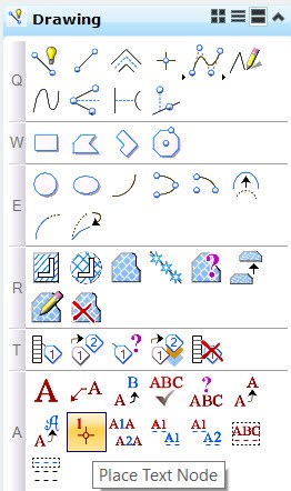

b) Click on Place Text Node.
c) Place Text node in such a way that it will align the Data into the table Graphics.
d) Now, Locate and Open: "node2da.txt" file from C:\ProgramData\Bentley\Plant V8i\Bentley Plant V8i Projects\SAMPLE_IMPERIAL\Config\OpenPlant\Isometrics\styles\As-Built\config\ node2da.txt
And write the syntax in the format (Node Number, Name of Entity), like here our node number is "70" and we have assigned it to the "WELD" as shown below
Finally, SAVE the file.

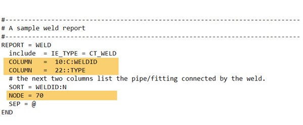

Step III: Modify the "report.def" file

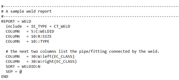

a) Locate and Open: "report.def" file  from C:\ProgramData\Bentley\Plant V8i\Bentley Plant V8i Projects\SAMPLE_IMPERIAL\Config\OpenPlant\Isometrics\styles\As-Built\config\ report.def
This syntax is already present in the "reports.def" file
b) The modifications required to be done in the default weld report are as follows:
In order to insert a column which has Application generated data (ex: Weld No, Shop Weld / Field Weld), you should individual syntax "COLUMN = 10:C: WELDID", the meaning of this syntax is :-
Also, you will be adding the syntax "NODE = Text Node Number", ex- (NODE = 70); this will attach the data of this report and it will be populated at the text node present in the isoseed file of the Isometric Style.
Your final weld report syntax will be: -
