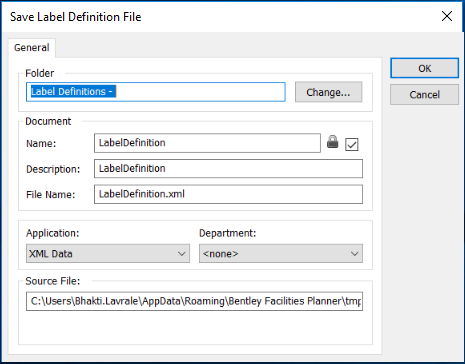

When you want labels to display every time a certain asset or area is also being displayed, turn on Use as Autodisplay in the Labeling dialog box. To be able to turn on Use as Autodisplay, you must first save the label definition you are configuring. To do this, choose File > Save As on the Labeling dialog box.
| Note: When Use asAutodisplay is not on for a label definition, changing the display filter inthe Asset Display dialog box will remove the labels from display. |
