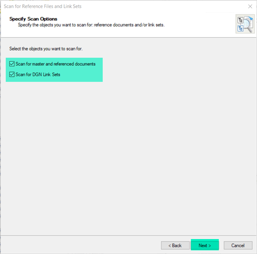

When documents are initially imported into ProjectWise, any existing physical relationships between the imported documents are kept, but the relationships are not yet recognized or managed by ProjectWise. To establish these relationships in ProjectWise, you need to scan the contents of the imported folders and files using the Scan for Reference Files and Link Sets wizard (Tools > Scan References and Link Sets) in ProjectWise Explorer.

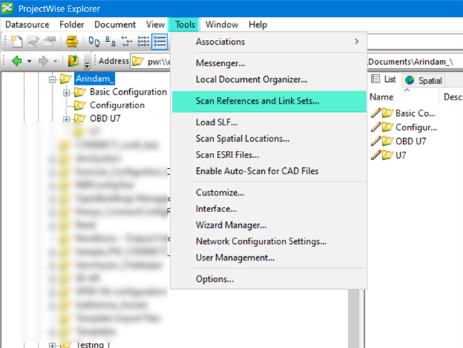

1. Open ProjectWise Explorer and click on Tools menu, and click on Scan references and link sets
2. Click Next into the welcome dialogue and in the next wizard check all options and proceed further.

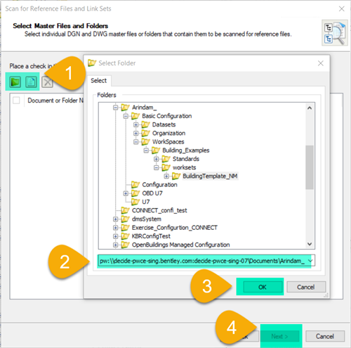

3. In the next wizard select the DGN files or one Specific folder the required DGN files. These are the DGN files for which we need to scan references.

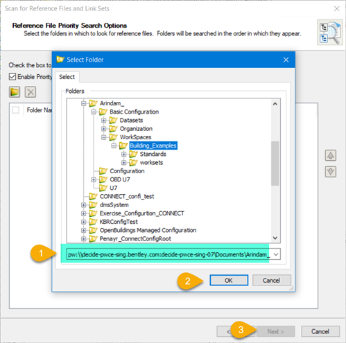

5. Select the folders in which to look for references files.

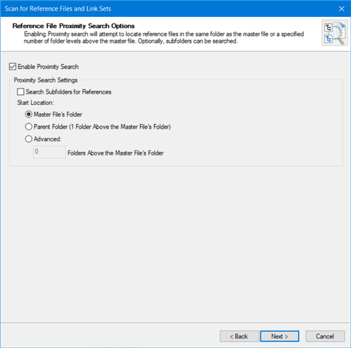

6. If proximity search is enabled PW explorer will scan for references from the folder of main DGN also.

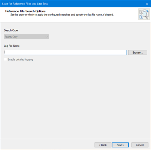

Specify the log file name if needed and proceed further.

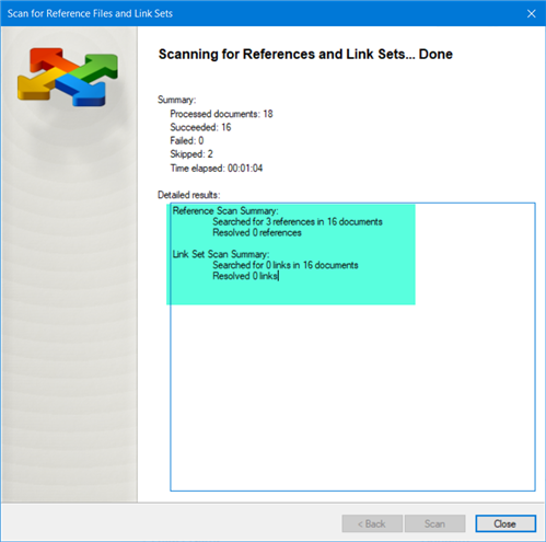

7. Click on Scan. The scanning process will start. Review the results and close the wizard.
