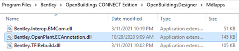

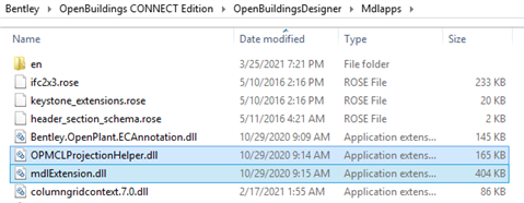

- Copy Bentley.OpenPlant.ECAnnotation.dll from C:\Program Files\Bentley\OpenPlant CONNECT Edition\OpenPlantModeler\Assembles\ to C:\Program Files\Bentley\OpenBuildings Designer CONNECT Edition\OpenBuildings Designer\Mdlapps\.

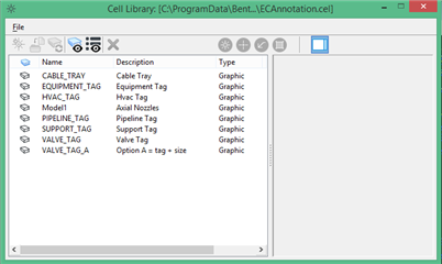

- Copy ECAnnotation.cel from C:\ProgramData\Bentley\OpenPlant CONNECT Edition\Configuration\WorkSpaces\OpenPlantExample\WorkSets\Metric\Standards\OpenPlant\Modeler\Cell to OpenBuildings Designer to the \Cell folder at either the Dataset, Organization, Workspace or Workset level:

- Update the following configuration variables in an applicable *.cfg file. These variables should point to the ECAnnotatation cell library that you’ve copied above. To help simplify the process, you can add these variables to a new text file and save it as C:\Program Files\Bentley\OpenBuildings Designer CONNECT Edition\OpenBuildings Designer\config\appl\opm.cfg.
MS_CELLLIST > [Path, 1, 2, 3 or 4 above]\ECAnnotation.cel
For example, using path 3 (Workspaces) above:
MS_CELLLIST > C:\ProgramData\Bentley\OpenBuildings CONNECT Edition\Configuration\ WorkSpaces\Building_Examples\Standards\Cell\ ECAnnotation.cel
MS_DGNLIBLIST > [Path, 1, 2, 3 or 4 above]\ECAnnotation.cel
MS_DGNLIBLIST > C:\ProgramData\Bentley\OpenBuildings CONNECT Edition\Configuration\ WorkSpaces\Building_Examples\Standards\Cell\ ECAnnotation.cel

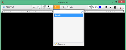

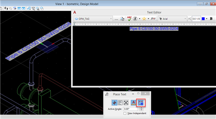

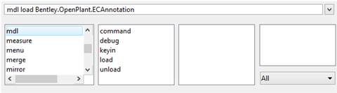

- Key In: mdl load Bentley.OpenPlant.ECAnnotation

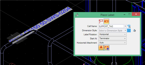

- OpenPlant Modeler EC Annotation will now be available using the Place Text tool with the Favorites option named “Sample”. Check that the Association lock is enabled, and if necessary, uncheck and recheck the box:
Or when using the Place Label by selecting the PIPELINE_TAG cell from the ECAnnotation.cel library.

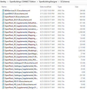

- NOTE: If you would prefer to use native *.dgn files in place of *.i.dgn files, you will also need to copy all 33 OpenPlant Modeler schemas from C:\Program Files\Bentley\OpenPlant CONNECT Edition\ECSchemas\ to C:\Program Files\Bentley\OpenBuildings Designer CONNECT Edition\OpenBuildings Designer\ECSchemas\. This is necessary in order for the native OpenPlant Modeler EC schema properties to be available to OpenBuildings Designer.

Copy OPMCLProjectionHelper.dll and mdlExtension.dll from C:\Program Files\Bentley\OpenPlant CONNECT Edition\OpenPlantModeler\ to C:\Program Files\Bentley\OpenBuildings Designer CONNECT Edition\OpenBuildings Designer\Mdlapps\.

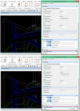

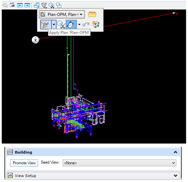

- In a 3D model, either apply the applicable Drawing via the mini-toolbar or use View Attributes to Promote the view.

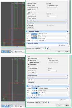

- In View Attributes you should now see an OpenPlant Modeler panel with a Promote button. When promoted, the OpenPlant Modeler piping and fittings should now display centerlines in that promoted view. You can now use the Centerlines toggle to control their display.
- Navigating to the drawing model, open the Reference Presentation dialog and you should now see an OpenPlant Modeler panel with a Centerline toggle as you did in the promoted view above. You can use this toggle to turn centerlines on and off.
