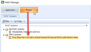

1. Go to Data Managers > HVAC Systems. The HVAC Project tab should open as below, with only the default steady-state HVAC (ie that used only in the steady state CIBSE Gain calculation) present:
2. To add a HVAC System to your Project, select Application. A thorough list of complex HVAC system types can be seen:
3. Each Category can be expanded to find the specific HVAC System you need. For example, see the numerous Fan Coil Systems below.

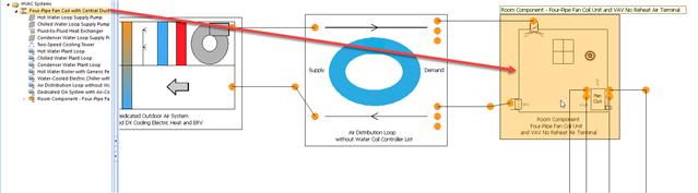

4. Left clicking on each HVAC system will display all the components that incorporate it, with options for a graphical schematic, or list of data:
6. To import the required HVAC system to your project, right-click on it and select Copy To Project:
7. Select Project, and the HVAC will now be available:

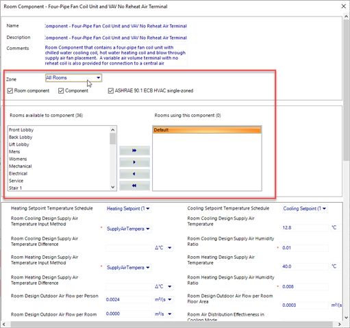

8. To Assign This HVAC to Rooms,
Select the Room Component in the schematic and double click on it:
The rooms / zones can be assigned, and you can set your HVAC design parameters:
Your HVAC System will now be available in to model in Simulations:
