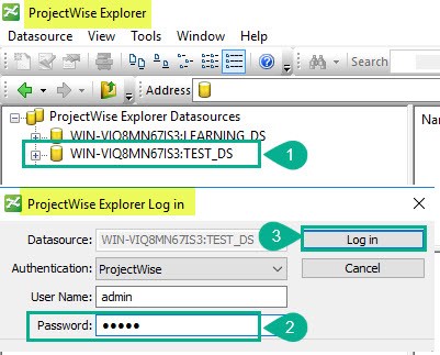

  2. Launch ProjectWise Explorer/Client CONNECT Edition
  3. Double click on the desired data source & log-in with the appropriate password as shown

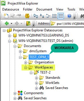

  4. Expand the workarea folder (here TEST_OPM_1) & search for workspaces folder as shown

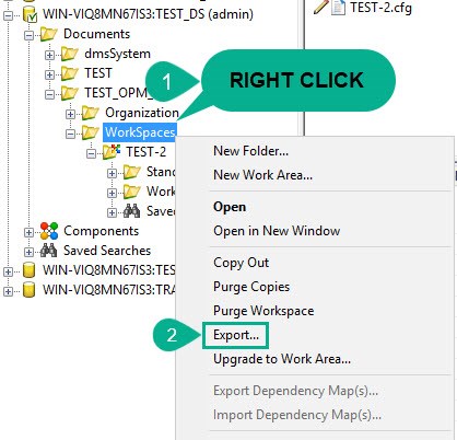

  5. Do right click on the workspace folder & select export as shown

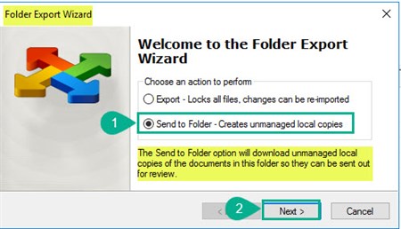

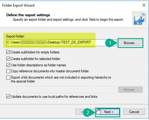

  6. The export wizard will open. This wizard contains two options Export & Send to Folder. Select the Sent to Folder & hit next as shown

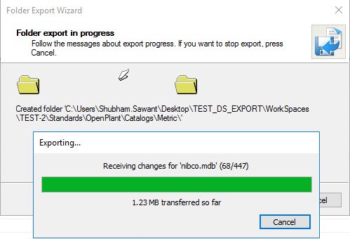

  7. Browse the desired folder where the workspace to be exported. Check-on the options below according to requirement & hit enter as shown
  8. The exporting progress dialogue will pop up as shown. Please wait till the next message wizard.

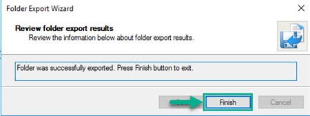

  9. Once done, Hit on the finish as shown below

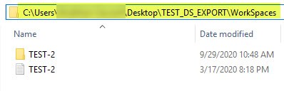

  10. Go to the allotted folder mentioned above in step-7 & verify the results.
