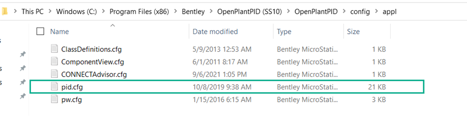

  1. Go to PID configuration - pid.cfg in following below mentioned location.
    C:\Program Files (x86)\Bentley\OpenPlantPID (SS10)\OpenPlantPID\config\appl

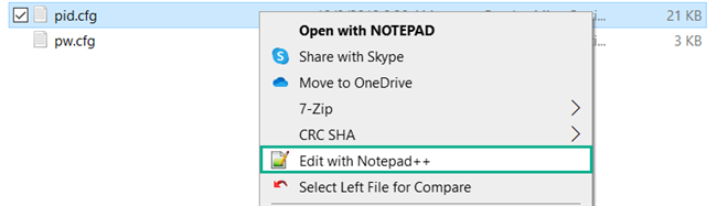

  2. Right Click the pid.cfg and Edit with Notepad++.

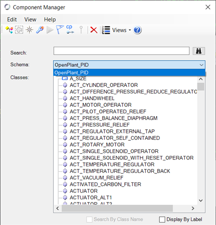

  3. Enter the desired custom schema name. Refer image below.
    BMF_COMPONENT_MANAGER_SCHEMAS < {desired custom schema name}
  4. Save all the changes and load OpenPlant PID.

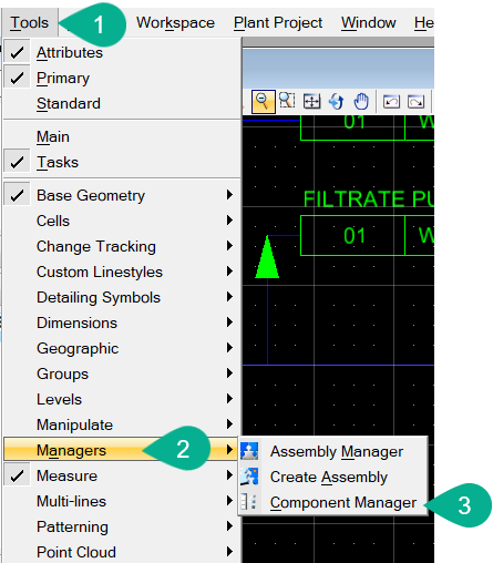

  5. Go to Component Manager and notice that custom schema gets enlisted as shown below.
