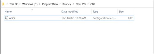

1.Go to below directory and open the at.ini file
C:\ProgramData\Bentley\Plant V8i\CFG
2.Add the below variable  SupportBrowserRootConfig=1

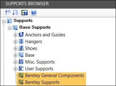

4.Open Support.ini file add following entry.
   Bentley General Components = bentley_gencomps.ini
   Bentley Supports = bentley_supports.ini
5.Save the file. and open Metric project Load Piping> Supports/Topworks Browser.
 Now it will show Bentley support.
