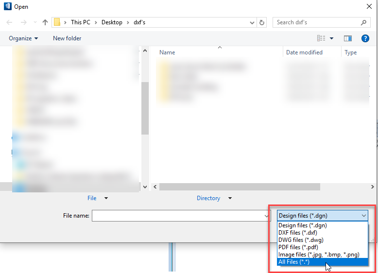

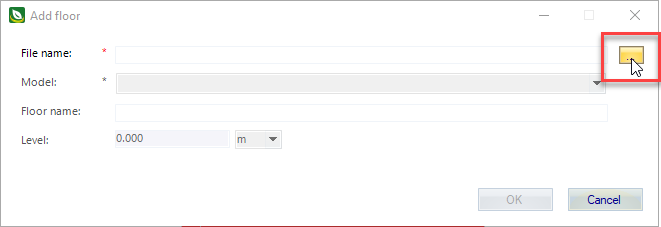

To trace your rooms a background plan is required. If you cannot find your floor plan, you may not have the correct format selected. This is covered below.

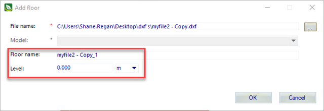

The floor will be created and your background will then appear, allowing you to commence entering rooms.
